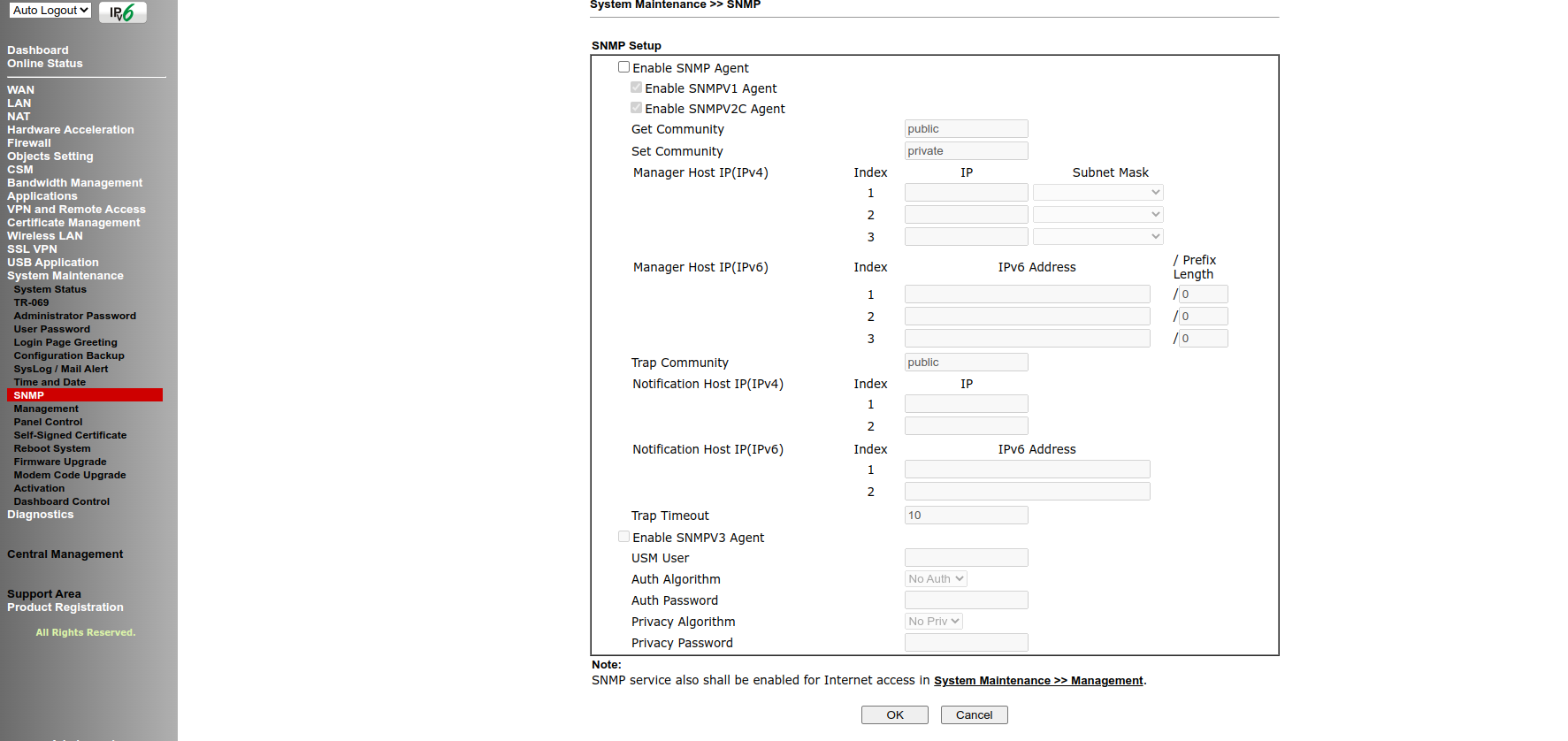

My router has a SNMP setup section. It was referred to in one of the links I followed from you
Not sure what to do though

What link?
Router stats or xDSL stats is the best way forward, along with the standard elimination of internal wiring. The Plusnet update suggests an issue on the consumer side if the NTE5.
Do the router logs indicate if there was a loss of sync or just a loss of PPP? I have (rashly) taken your “disconnection” statements to imply a kiss of sync, rather than just PPP. They are not the same.
