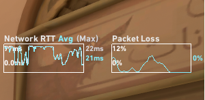

Been playing a few games @jab1, and the ping spikes are really noticeable, packets also seem to drop in game whenever a lag spike happens, theres no other devices on the network that could be using the bandwidth to cause itimage.png

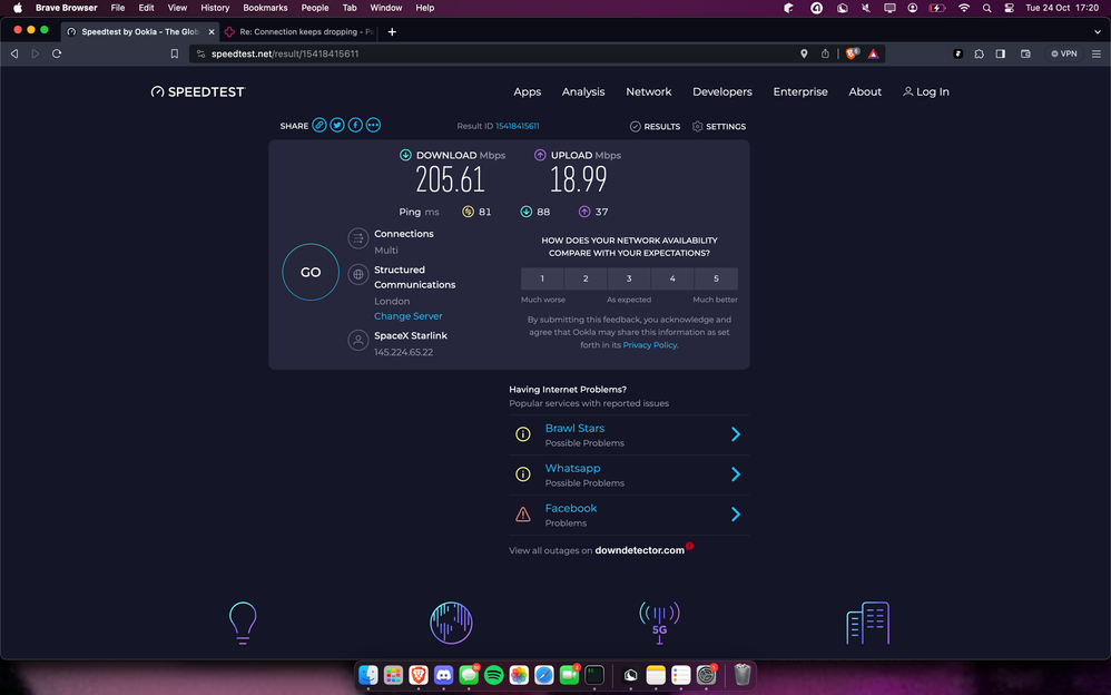

Received my starlink, will be using it until OR can actually fix the issue I'm facing
