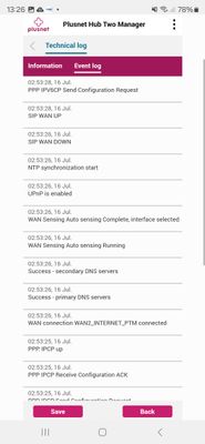

@RealAleMadrid Agreed - but I'm just wondering if the DSL circuit is failing, too -note the low uptime.

Just a thought
The Hub two technical log screen shot shows a time stamp of 09:47, the DSL uptime is show as 6 hours 49 minutes.
Assuming the technical log was post just after being captured that could make the sync time around 03:00 in the morning, possibly a DLM resync?

All could be answered (or not) if we see the event log.

Screenshot_20240716_132943_Samsung Internet.jpgScreenshot_20240716_132939_Samsung Internet.jpgScreenshot_20240716_132930_Samsung Internet.jpgScreenshot_20240716_132926_Samsung Internet.jpgScreenshot_20240716_132919_Samsung Internet.jpgScreenshot_20240716_132913_Samsung Internet.jpgScreenshot_20240716_132904_Samsung Internet.jpgScreenshot_20240716_132856_Samsung Internet.jpgScreenshot_20240716_132849_Samsung Internet.jpgScreenshot_20240716_132844_Samsung Internet.jpgScreenshot_20240716_132836_Samsung Internet.jpgScreenshot_20240716_132832_Samsung Internet.jpgScreenshot_20240716_132805_Samsung Internet.jpgScreenshot_20240716_132811_Samsung Internet.jpgScreenshot_20240716_132821_Samsung Internet.jpgScreenshot_20240716_132825_Samsung Internet.jpgScreenshot_20240716_132758_Samsung Internet.jpgScreenshot_20240716_132754_Samsung Internet.jpgScreenshot_20240716_132747_Samsung Internet.jpgScreenshot_20240716_132742_Samsung Internet.jpgScreenshot_20240716_132736_Samsung Internet.jpgScreenshot_20240716_132730_Samsung Internet.jpgScreenshot_20240716_132722_Samsung Internet.jpgScreenshot_20240716_132718_Samsung Internet.jpgScreenshot_20240716_132711_Samsung Internet.jpgScreenshot_20240716_132705_Samsung Internet.jpgScreenshot_20240716_132656_Samsung Internet.jpgScreenshot_20240716_132652_Samsung Internet.jpgScreenshot_20240716_132643_Samsung Internet.jpgScreenshot_20240716_132637_Samsung Internet.jpgScreenshot_20240716_132629_Samsung Internet.jpgScreenshot_20240716_132626_Samsung Internet.jpgScreenshot_20240716_132622_Samsung Internet.jpg
I canf upload the whole lot will let me upload only 50 a day. Is this okay? I don't really know how to upload them better

@Ragismiks To upload the log as we need it, you click the 'Export' tab in the picture I posted, and  attach the reset to a post - that will post the log as a .csv file which we can then read and interpret.

It doesn't show export option on mine. I can't upload any more screenshots either now.
I went technical log - there's choice between information and event log. Pressed event log and it doesn't gave option od export
