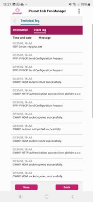

@RealAleMadrid Agreed - but I'm just wondering if the DSL circuit is failing, too -note the low uptime.

Just a thought
The Hub two technical log screen shot shows a time stamp of 09:47, the DSL uptime is show as 6 hours 49 minutes.
Assuming the technical log was post just after being captured that could make the sync time around 03:00 in the morning, possibly a DLM resync?

All could be answered (or not) if we see the event log.

@Ragismiks To upload the log as we need it, you click the 'Export' tab in the picture I posted, and  attach the reset to a post - that will post the log as a .csv file which we can then read and interpret.

It doesn't show export option on mine. I can't upload any more screenshots either now.
I went technical log - there's choice between information and event log. Pressed event log and it doesn't gave option od export
