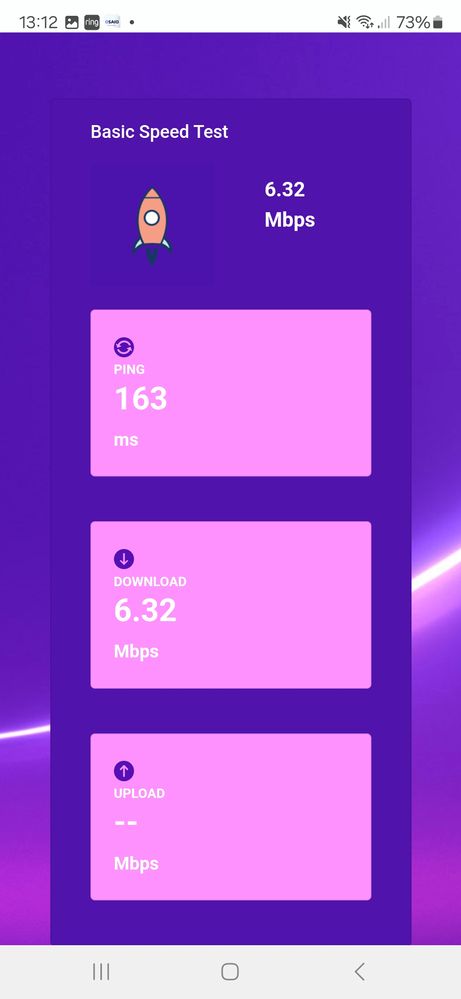

Screenshot_20240710_131157_Samsung Internet.jpgScreenshot_20240710_131212_Samsung Internet.jpg

@Ragismiks There is obviously a fault somewhere, which the PN 'reset' pbviously hasn't fixed. In order for other Community members to possibly help, can you follow the below -it will give us asolid starting point.
As an aside, your 'ping' is atrocious, and whatever is causing it is probably a major contributor to your isse.

You say: my speed doesn't even meet half of the speeds etc email says. You then report speeds between 6 and 8 Mbps.
Can you confirm your actual guaranteed speed as it sounds that you are either on a very long FTTC line or ADSL. You also say that your family is streaming from Netflix and gaming on an Xbox.
Are you ensuring that none of these are running at the same time as you are conducting a speed test? To be honest, regardless of whether or not you have a fault, based on your information I would question whether your current connection is capable of providing the speed required to satisfy your family needs.

@Baldrick1 Until we get a response (if we do) to my post above, I think the ping results provided are part of the problem. Maybe we wait and see?

We obviously need to wait for a response to your post  However, I also think it worth testing the assumption that there is a fault. The ping could be due to buffer bloat caused by other running services.

Agreed, @Baldrick1 . If the OPs network is running concurrent intensive services though, on an FTTC service, then their results could be expected.

There are a couple of clues in the "Fast" results.
An upload of 1.8Mb/s suggests VDSL
