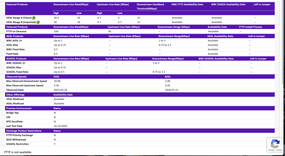

milvusmilvus
Posts: 26
Registered: ‎25-04-2019
Re: Banded Again ?
Here you go...
RealAleMadrid
Posts: 3,241
Thanks: 1,861
Fixes: 68
Registered: ‎07-07-2009
Re: Banded Again ?
@milvusmilvus  As I suspected it is pretty obvious that the line is still banded despite being told the speeds are correct which they are not.☹️ I do not know why speeds at the very bottom of the expected range only just above the handback threshold would be deemed to be correct.
In a previous post of yours from some time ago  (msg 19 of this thread) Previous Thread  after a DLM reset you had a download speed of 27.351 Mbps with SNRM of 6dB so that is a reasonable speed for the line.
I would dispute the assertion that the speed is correct and ask for a DLM reset.  The problem is that on a long line you are likely to get connection drops and banding may get applied again if they are frequent.  This is the way that DLM controls VDSL2 lines that are unstable. The speed is capped at a lower value causing the SNRM value to rise above the normal 6dB.
@csmith94 You have not answered my question about the high SNRM value, which is usually a strong clue that the line is banded. Perhaps you could post the GEA test information or at least the downstream profile name.
