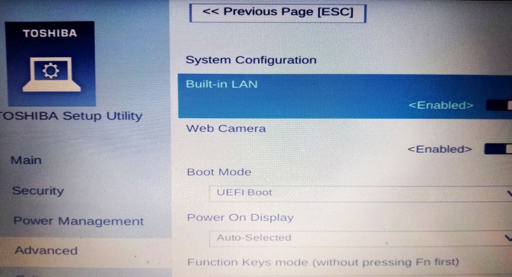

Re: What does this mean ?
Have not been messing with the bios, for as far back as I can remember !
current bios
Hmmmm that is strange indeed! Does the boot device order have a network option in the list? If not, maybe try turning the network device off in the BIOS just to see if it makes a difference? (ETA; the built in LAN option?)

It's trying to boot from a  server image over the network, that's what PXE Boot is.
You'll need to find the boot priority (or similar) settings in the BIOS and change them to move PXE down the list or remove it.
Probably little point in trying to figure out how it got enabled or prioritised.
It seems very unlikely that hardware damage or failure is a cause.
