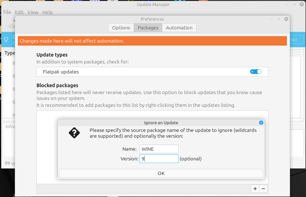

While you were all busy... I found this,by accident.. ( finger slipped on the mouse moving across the menu ! ) .of Update Manager.
Click on the + and type in the name /or copy it from the update list.
Have done the above... and also have done @outcast  version ... so a bit of belt and braces.. with @dvorak suggestion on hold if neither of them work! ! .
