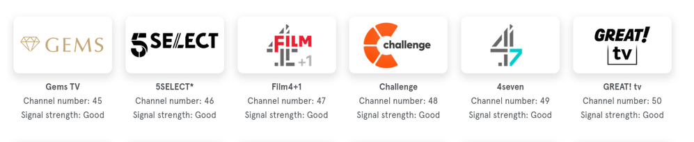

@Anonymous   Thanks for the linky....
here is a screen grab showing ch 46 as Good  - as with other channels. channel 46 and others.pngchannel 46 and others.png
