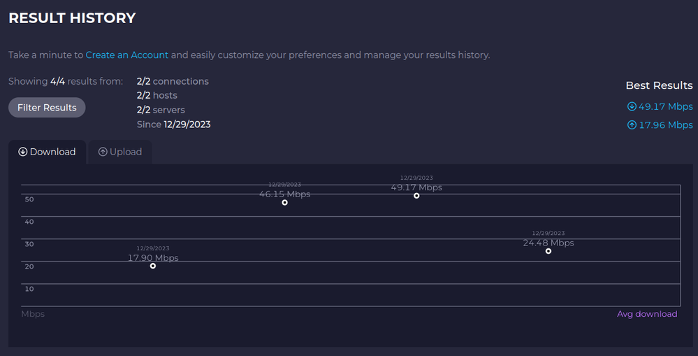

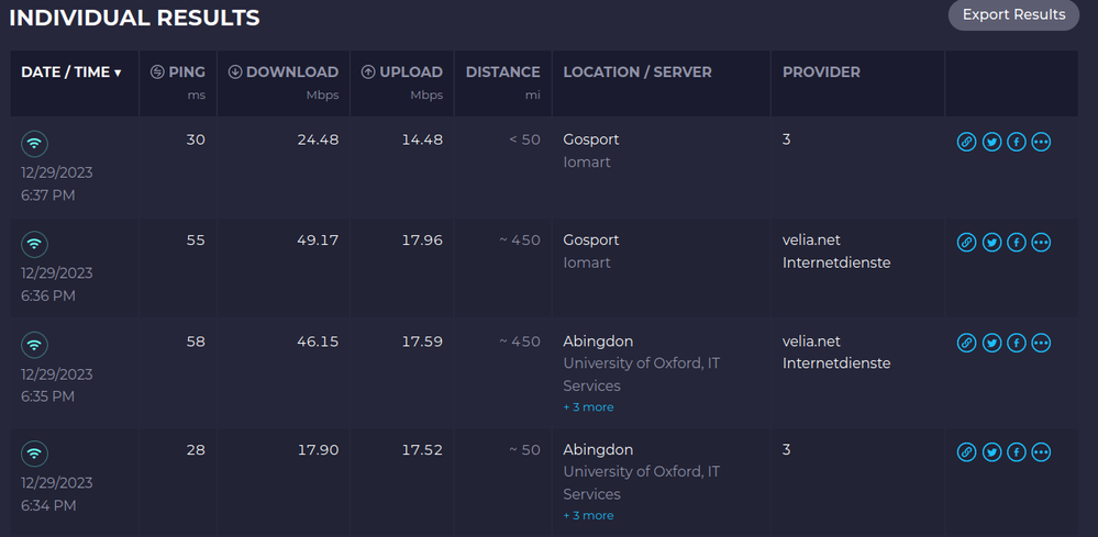

My internet connection is via a 4G LTE router running on the Three network with a SMARTY SIM only deal.
Laptop is connected to the router via ethernet cable.  Router has home built Twin Yagi antennas replacing the "bunny ears" and pointing on the compass bearing of the Mast about 2 miles away, up hill, and just over the top of the hill the other side. No direct line of sight, to the Mast. as the intervening 2 miles is dense urban housing.
18:34  Run a speed test with OOKLA... resulted in a
PING of 28 ms and a speed of 17.90 Mbs down to a server in ABINGDON ( about 100miles as the crow flies from me)
One minute later.
18:35 Switched in a freeby VPN ( Courtesy of Firefox Addons ). repeated the speed test via a VPN in Germany ( distance 450 miles )
PING 58 ms    resulted in a speed of 46.15 Mbs via same server in ABINGDON
One minute later.
18:36 Still on the VPN...changed the server to a "local" one in Gosport      Repeated speed test.
PING 55ms  speed 49.17 Mbs
One minute later
18:37  switched out the VPN.. so direct to the Gosport Server...
PING 30 ms    Speed 24.48 Mbs
Not "that" concerned about hi speed,  as I don`t do gaming or watch TV on line....  so just an "academic interest in it.
Seems a bit strange that using a VPN  boost the speed by a factor of x2. going via Germany, to the local server in GOSPORT, ( or ABINGDON )
Can anyone explain why this should be?   ( it`s not a "one-off" situation, I have run this kind of test a few times at varying time of day...and the difference in speed is always the VPN gives double the speed, compared to without the VPN . )
