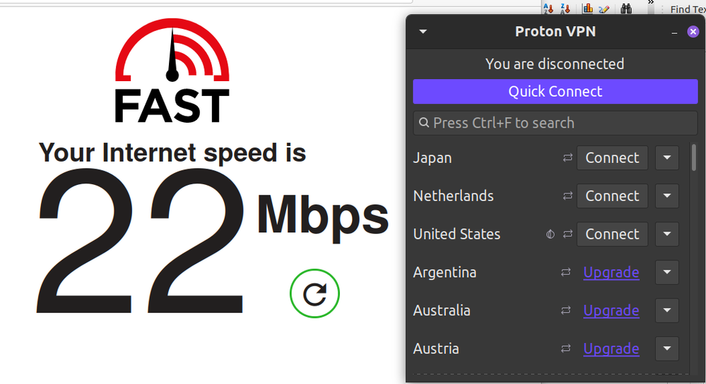

so here is some very interesting comparisons of speed tests with and without the PROTON VPN in operation.
First one is using the "FAST" speed test site.... note the Proton stating "you are disconnected".

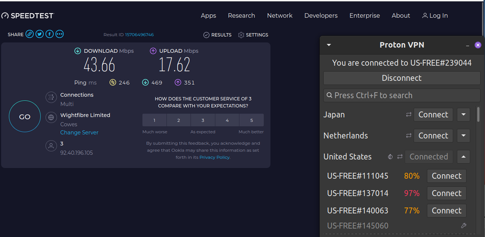

To check that it was not a FREAKY result.... I then tried the OOKLA speed test...
here it is with NO VPN connection...
and here again.... shock result.... with PROTON VPN connected...

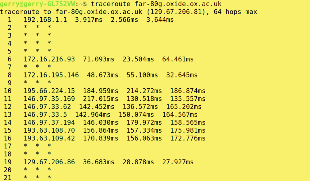

OK.... traceroute - traceroute far-80g.oxide.ox.ac.uk
NO VPN

This is my best efforts looking at the traces (sorry if it's disappointing, but I'm not a network engineer...)
VPN Route:
Hop IP Adrs Comments.....
1. 10.96.0.1 Private IP adrs - assume it is the VPN internet gateway
2. 31.13.189.225 Router in New York - assume the public IP of your VPN
3. 146.70.0.221 Secaucus, New Jersey, United States - assume an internet router
4. 62.115.183.74 Jersey City, New Jersey, United State - assume an internet router
5. 62.115.136.46 New York City, New York, United States - assume an internet router
6. 62.115.113.21 London, England, United Kingdom
7. 62.115.122.189 Hendon, England, United Kingdom
11. 146.97.37.194 Hayes, England, United Kingdom -
12. 193.63.108.70 London, England, United Kingdom
13. 193.63.109.42 Oxford, England, United Kingdom
...... rest of trace is missing, but we are close to the speed test server
non-VPN Route:
1. 192.168.1.1 Private IP Address - shutter's internet router/gateway
..... some hidden/non-responding routers in Three's network?
6. 172.16.216.93 Private IP Address - presumably inside Three's network
8. 172.16.195.146 Private IP Address - presumably inside Three's network
..... (I'm not sure why shutter's public IP address doesn't seem to have show up here somewhere)
10. 195.66.224.15 London, England, United Kingdom - assume an internet router
... then it seems to take similar router addresses to Oxford University servers
The round trip times shown to each of the routers aren't very different. My guess still is that the VPN application is successfully compressing the speed test data across the VPN tunnel so the total data is travelling more quickly over the slower parts of the connection. Going much quicker to and from New York over the VPN (because is has been compress to a much smaller size) than the uncompressed data is able to travel through Three's network.
Across the other hops outside of Three's network and outside the VPN the speed of transmission is probably very quick and not constrained by the 4G network connection....

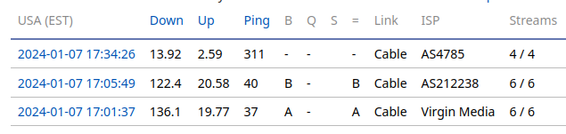

Gave it a quick run on laptop with Proton VPN (Japan and Netherlands servers) and without VPN:
