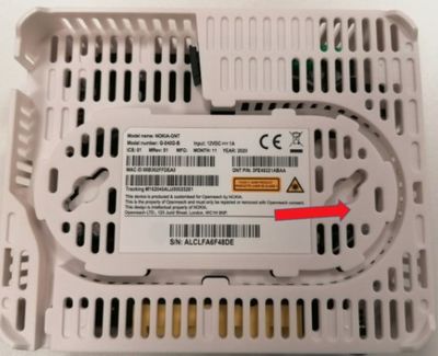

The images posted in the article by ISPreview don't seem to show the optical port all that well.  The red arrow points to middle of nowhere?

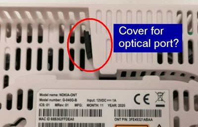

If you study their image more carefully, does that look like a dust cover for optical port?

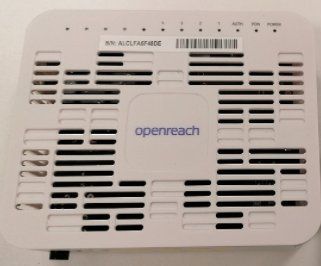

It's also one ugly ONT to look at.  Unless it is some form of fashion statement, all those ventilation slots may suggest the unit gets toasty in use?Huh
