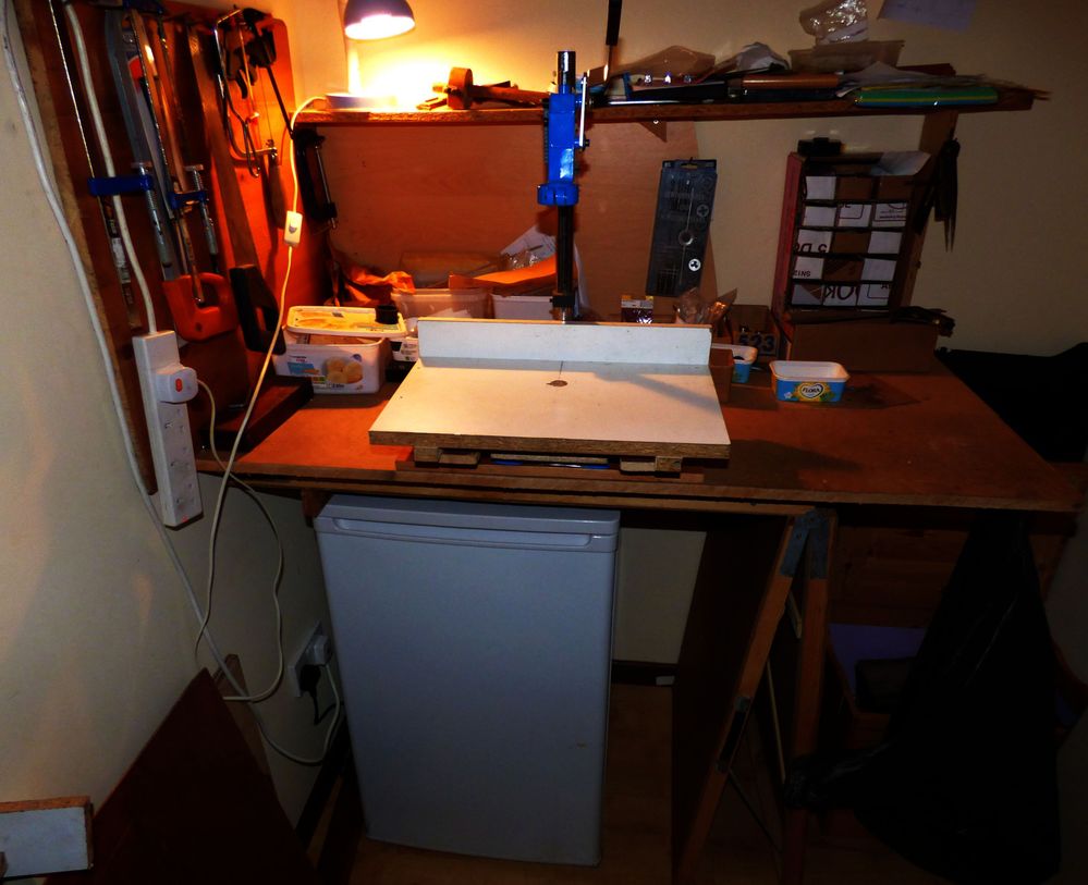

Test pic...
As you can see,...  ( although this is slightly darker than the true pic on my screen).... the drill stand is a really bright blue... and in the bottom right corner, there is a black bin bag with something behind it.... this is totally darkened, and you cannot make out the bag or the shape/colour behind it . There is a piece of board in the bottom left corner that is brown in this pic...but it shows as almost black, the wall behind is white  and so is the fridge front... but in the printed pic they are greyish
there is a grey object at the back to the left of the set of drawers,  on the printed pic it is blackish, and inefinable as to what it is.
I have tried to replicate it by adjusting the gamma on this pic, ( adjustment was -0.50 )

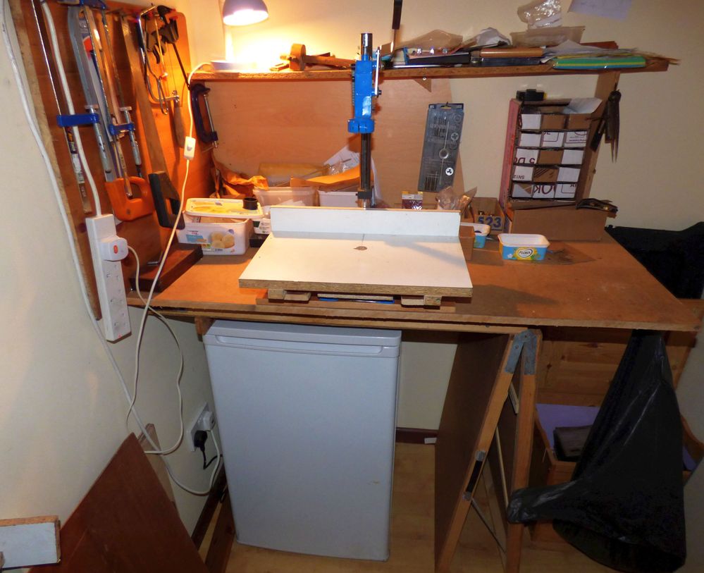

I have tried adding 0.50 gamma to the original, ( to try and "compensate" for the darkness)... but it seems to "wash out" the colours .  Apart from the colour/brightness the print quality is excellent.

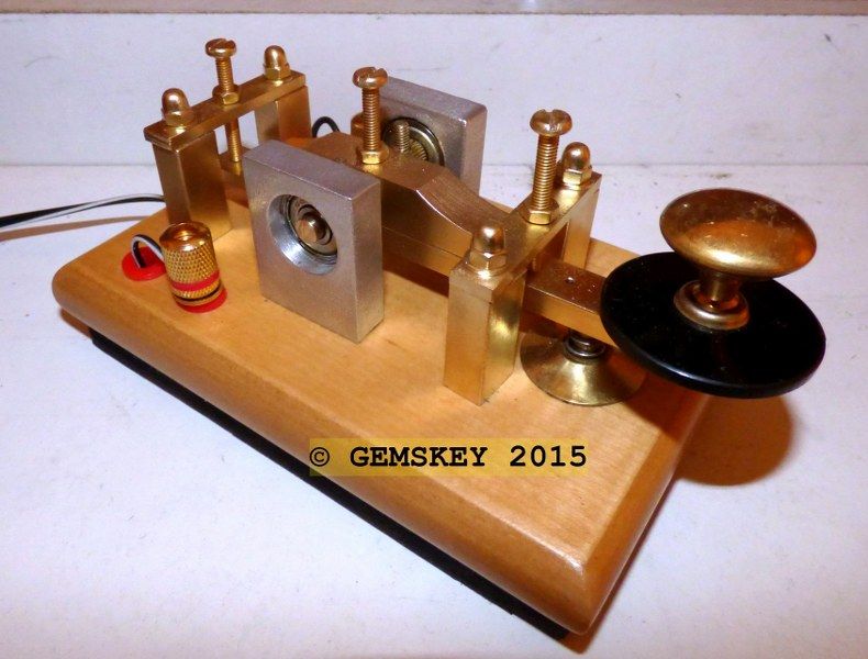

As you can see, the base is a very light wood.. The aluminium is the correct colour, and so is all the brass parts.
Note also the yellow background to the (c) GEMSKEY 2015

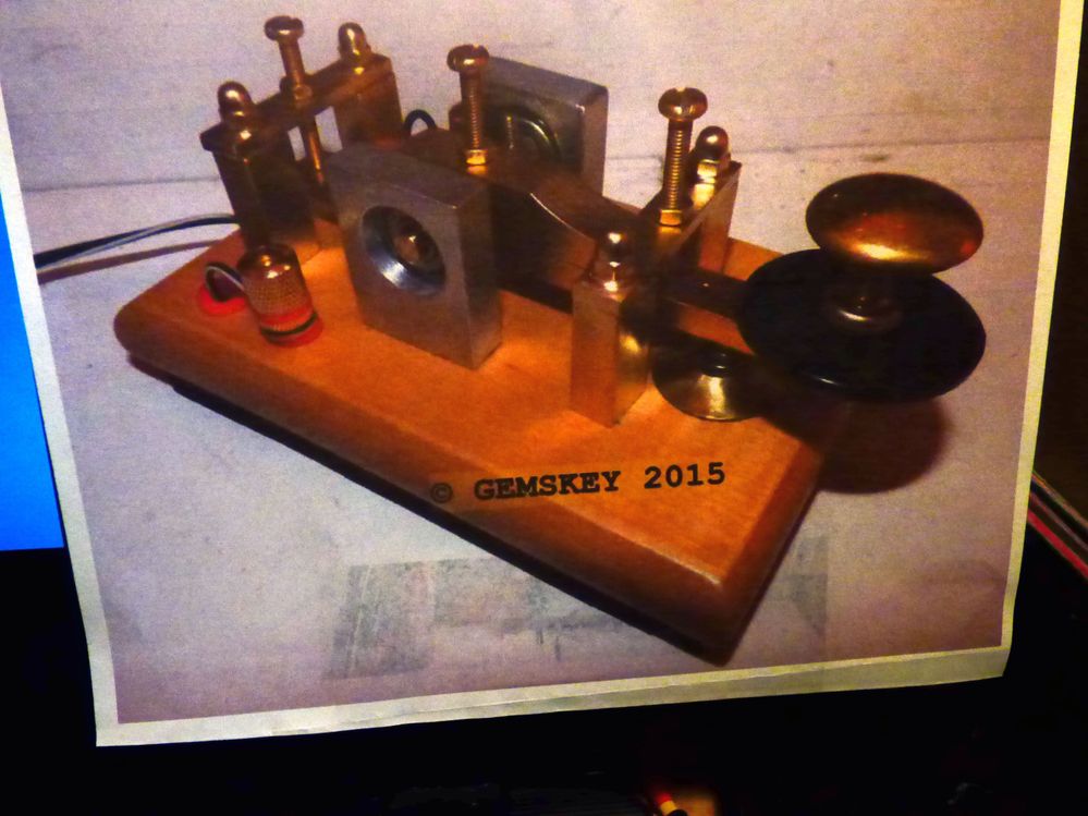

Here is a pic from the printer...
OK>.. it was printed on "plain A4 paper"... because it is not easy to photograph photo glossy paper !.. but I can assure you that the colouring is the same on photo paper.
The base wood is now a brown colour, and the whole picture looks a lot darker over all .

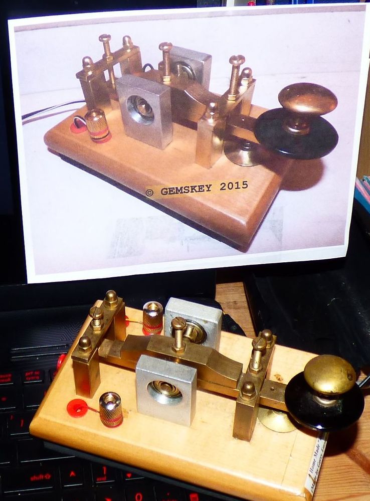

Here is a pic of the pic, and the actual key below.  so you can judge for yourself regarding the differences that the printer does, compared to the actual key.
The printed pic looks a lot lighter there, over all, because of the overhead anglepoise lamp used to light the scene.
however.. it does show the difference in the wood colouring , and a better reference to the colour change is to compare the key in the lower pic, to the single pic above this one.
Indeed... compare the top pic ( original used for the printer test)  to the latest pic at the bottom, of the acutal key.  which is what I would expect it to be printed like.  (i.e. not darker ) .
