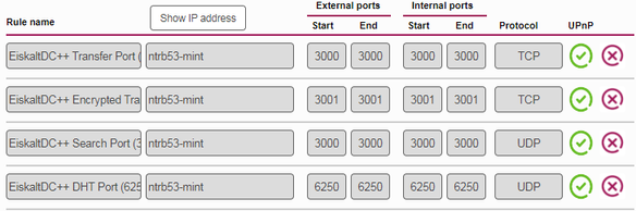

I have been asked to check all my EiskaltDC settings again. Which sort of brings me back to my original question; about how to open a TCP port (part of the setting up process). Hunting around in my Hub 2 settings, I can across the attached, which mentions ports. Does this help to shed any light?

Did you add those port forward rules titled EiskaltDC? those rules forward any external traffic on port 3000 TCP/UDP and port 3001 TCP to the PC name Bs-iMAC

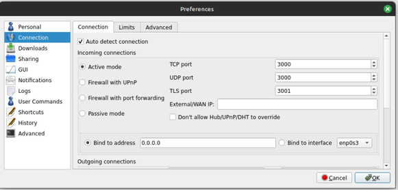

Looking at the EiskaltDC app preferences there is an option for 'Logs' maybe try enabling 'System messages' to see if that provides any help information when you try connecting.

Been checking some more, can you delete the current three port forward rules for the name EiskaltDC++
Then make sure the EiskaltDC++ connection setting is set for "Firewall with port forwarding"
Then on the Hub Two create the three rules manually and try again

I have run into 2 small problems recreating those port assignments. I can create the first rule (called EiskaltDC++ Transfer Port) no problem, but when I try to create the next one, when I save it, it's not listed. The name is I believe EiskaltDC++ Encrypted Transfer Port.
Advance Settings>Firewall>Port Forwarding wouldn't let me replicate what I originally had as rules; there were two rules which used ports with the same number (screenshot above), but I couldn't save the second rule I tried to (re)create. I was told that the port was already in use.
How important are rule names? The page you sent earlier is not especially helpful for that. It seems there is limited space to put in a long name, although I am flying blind to a degree, as I didn't save a record of my original rules. My screenshot above just says " EiskaltDC++ Transfer Port ( " and " EiskaltDC++ Encrypted Tra " and one other.

Great, thanks. I have now deleted and created my rules again and saved them to my Hub 2 account. I think that I had one of them as a TCP when I should have had it as UDP, now corrected.
So it's now (see attachment)
I see that the top ones (which work fine) have a grey background, whereas the ones I created don't.
I am getting the dialogue "Do you want the application "EiskaltDC++.app" to accept incoming network connections?", which is an improvement over previously, although the network service still isn't showing me a file listing of any kind, viz:
