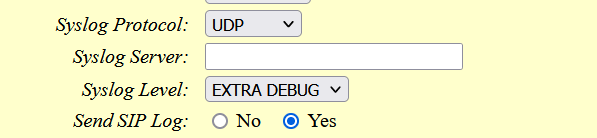

Enable Logging in Advanced Settings:
Then see if there are any clues in the SIP File, see tab at bottom of the Status page.

Looking at the SIP log it is showing a couple of failures when RECEIVING from A&A.
It throws up:
SIP/2.0 401 Unauthorised
SIP/2.0 403 Forbidden
Any ideas?
