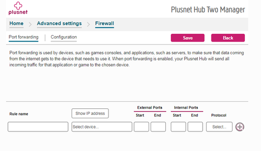

Hub One had predefined rules, all you see with a Hub two is:-
May have to use openVPN as an alternative
Edit: just SIP alg
