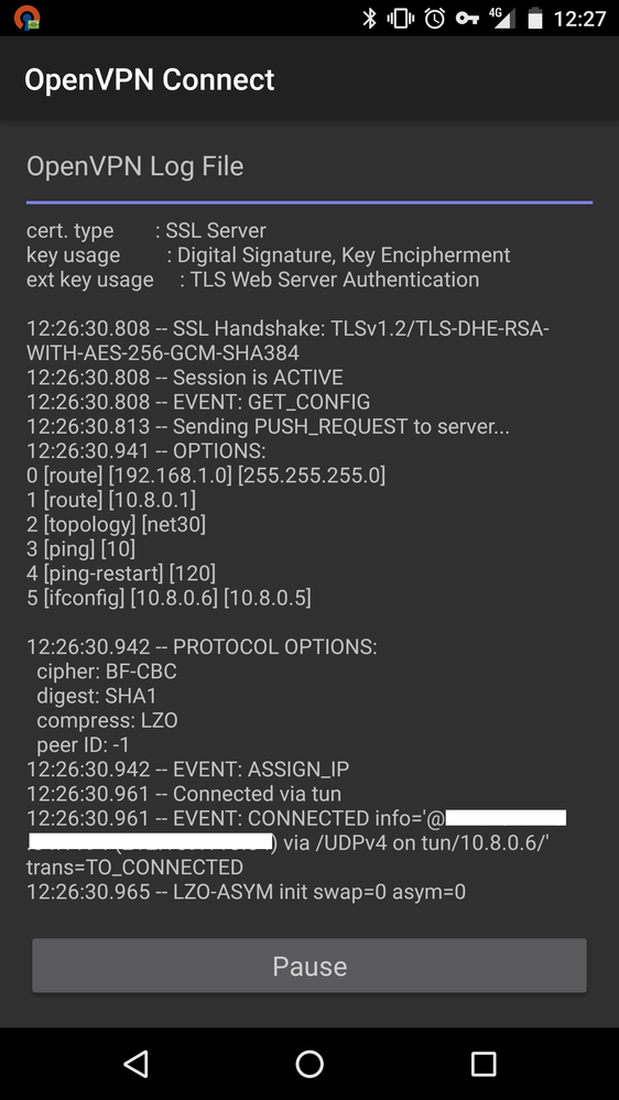

this is the connection log showing on phone when connected to VPN
