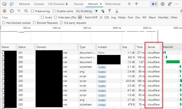

@AlessioC wrote:
I forgot to mention, the 522 errors are not on the page, they are on single resources (mostly javascript files) served by the application. So the page loads but malfunctions.
In the Network view of the browser debug console, there is probably a 'server' column that indicates the origin of the resources in question.
Maybe that offers some clues?

AlessioC
Posts: 3
Registered: ‎17-03-2022
Re: Occasional HTTP 522 with self-hosted server
@bobpullen  I did as you suggested, and the content is coming from Cloudflare.
After a bit more playing around I think  the issue is entirely with Cloudflare. After realizing I could check the server I disabled Cloudflare's proxy, cleared the DNS cache and waited until I started getting responses directly from Nginx on my Raspberry. So fare I have reported 0 522 errors when the reply was coming from Nginx.
I think I was fooled by the DNS cache, I thought I was bypassing Cloudflare but it was still active. Thank you all for your assistance I will focus my investigation on Cloudflare.
