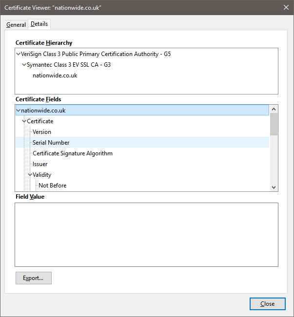

I might just have answered my own question. I have tried disabling Kaspersky Add-ons and Extensions in Firefox and it is still reporting Kaspersky as the verification authority, so Kaspersky obviously has it by the throat. However, this only extends my query, could some other verification authority security package that hadn't properly done the necessary with Nationwide in terms of certification got it's teeth onto @shutter computer, hence no verification cerificate?

What does the certificate hierarchy look like for @shutter's Firefox-derivative l wonder?
Re: Non- Secure connection warning message
In all honesty @Baldrick1 Kaspersky is sticking their virtual nose in where its not wanted. When you buy a certificate you get it from a Certificate Authority. As you can see from @bobpullen’s post the Nationwide bought their certificate from Symantec who are acting as a Certificate Authority but who in turn got their issuing authority from VeriSign.
As for @shutter I don’t know what if any, AV he uses but even then, it may only have a side effect of saying something similar to what you are seeing. What we need to understand is why his various browsers are flagging the certificate as insecure.
It may be that that there is an issue with the Root CA as used by Mozilla on his machine(s) so to test it he would need to set the security.enterprise_roots.enabled flag to true in order to use the same certificate roots as used by I.E.

Symantic is the CA for the certificate. To confirm that the Nationwide site is reached securely the certificate has to be accessed. So every time you log into Nationwide does the browser get the certificate details from Nationwide, go onto a Symantic database, or is a copy of the certificate stored somewhere on the local computer in some sort of cache? If so, does each browser have it's own cache?
Edit. I've answered my own question, they are stored in the browser under Options\Privacy\Certificates. Is this why @shutter can use IE11 and not Firefox? Not that it helps as he's re-installed Firefox, which I note is now at 57.04.
@Baldrick1, the certificate from the bank isn’t held on the client it is only the root CA certificates that are provided with the browser (or those you add yourself) and as mentioned before these are used to authenticate the chain of authority when you encounter a server certificate. In bobpullen’s post above he is showing the Root CA Certificate that would be used to validate the Nationwide one.
