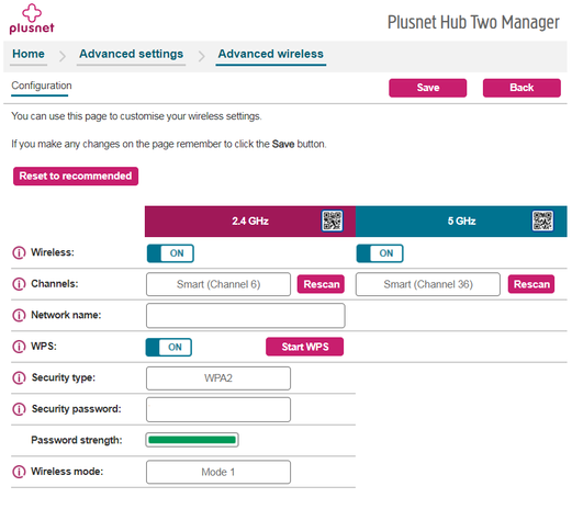

Did you try making the Hub Two Wireless network name (SSID) the same as your previous router?

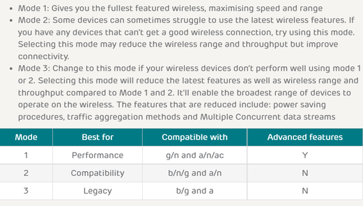

Within the settings of the Hub Two wireless network is the ability to change the mode, the default being Mode 1 (see below)
I made this suggestion on another thread where someone was having issues with the CCTV, they changed the Mode to 3 set the camera up and put it back to Mode 1 after they connected.
HTH
