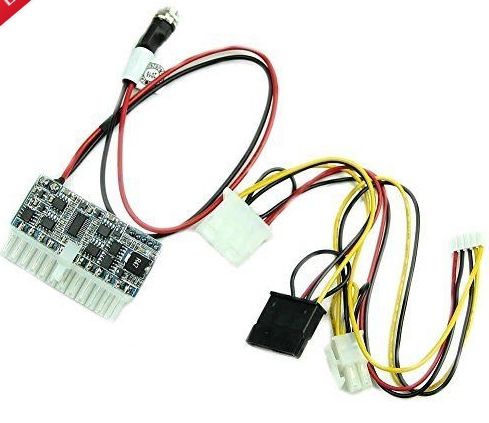

So I clearly have a dodgy silent PSU. Here's the problem - there are two parts to it. It's a micro ITX power supply that plugs into the motherboard with some micro wizardy mounted on it in the electronics dept and then a 12V 10A DC adapter that plugs into that. Here's what I mean:
screenshot-924screenshot-924 screenshot-925screenshot-925
I've checked the 4 pin processor connector voltage, that is 12V. I've checked the voltage at the molex - yellow is 12V and red is 5V. The only thing I can conclude is that one of them PSU parts isn't supplying enough current - I had these same symptoms when i tried a 3A supply months back hoping i might get lucky lol. As the normal ATX PSU makes it all work there is clearly a power issue and to me, it looks like it's a lack of available current.
The 24pin connector i've no idea where to start. Also I've no idea how to test the DC adapter. Both parts came from different suppliers.

Well that did the job... soldered a couple of wires onto a 2.5mm DC jack plug, clipped the other ends onto the car battery and plugged it into the pico ITX supply and hit the power button. Booted with no problems.
Tried the DC adapter again, no boot.
Now I know it's the DC adapter.

The seller has sent a replacement AC adapter (the black thing pictured) after saying that he'd send a tested replacement. It arrived in different bubble wrap to the other and has clearly been used / tested so I assumed it would work.
Naturally, it doesn't.
So I found myself thinking that there must be something amiss here. The first AC adapter worked fine - for hours until it was shut down - at that point it gave up.
So.. I found myself looking at the pico PSU with the 24pins. It definitely works when connected to a car battery - with almost unlimited current supply - but not when connected to the brick. So.. i dug through my emails to discover that it's a 250W unit and tracking it down on ebay, says "Maximum" input current of 17A.
Now correct me if I am wrong.. but the AC adapter with 10A output and a 250W max PSU should work okay with a
board that has a TDP of just 13W right? - by that I mean just because it says 250W doesn't mean that it's going to actually draw enough current to output 250W does it? - It's a maximum not an actual output right? - More to the point if it won't work then why did it the first time?
With that said, it only works via the car battery so I'm now wondering if it actually does draw more amps than I thought even if the motherboard itself doesn't need all of that current?
So.. I looked at the 24pinner on ebay and it does say it's for car / auto use. It specifies 12V DC in however the last I checked, cig lighter socket voltages go up and down and aren't stable. So how on earth does one use this poxy 250W thing if it needs a stable 12V supply at a silly high amperage?

It says:-
DC Input: 12V
Output ATX: Max 250W
Standard 24pin ATX Power Connector
Appearance size: 55*35*13mm; PCB size: 55*22mm
Input Current: Max. 17A
Output ATX: 250W
Output Current +12V: 8A
Output Current +5V: 8A
Output Current +3.3V: 8A
Output Current +5VSB: 1.5A
Output Current -12V: 0.1A
Output Power: 250W
Apart from those numbers not adding up, which voltage is the problem?

That's the whole point though, those are maximum ratings so it's irrelevant.
The manual for this mobo clearly states that it draws a max of just over 8A when tested and pushed hard - so this AC adapter should be able to do it.
Current affects power... so 12V x 8.5A = 102W (at maximum consumption).
I'm stumped! I can only think that teh pico PSU is drawing more current than it actually needs to or the second ac adapter i've been sent has also decided to die after being used for testing by the seller. The latter seems unlikely but not the first time a batch of identical products has had the same fault..
