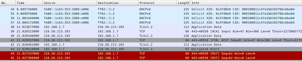

Have you tried a speed test using a wired connection, ideally trying both routers?
Also, you could investigate wifi using Wireshark - which will tell you if you are getting lots of re-transmit requests on your wifi. You should expect to see a few, but each re-transmit will slow your connection down tremendously.
Sample:-

Unless you can use "monitor mode" on the wifi, wireshark won't see the re-transmitted packets on the wifi. Looking at the wifi using monitor mode would be very useful to see exactly what's happening, but isn't easy to do on Windows. Older versions of the free Acrylic Wifi scanner program can do it, as can Microsoft Network Monitor (and presumably its successor), how well monitor mode works also can depend on the wifi card and its drivers. It's easier to do with wireshark on Linux.
There are a lot of different parameters for 11n wifi (for things such as the frame aggregation method, the protection mechanism to use when legacy devices are present, or various optional features to improve speed or signal reliability). Unfortunately I think most wifi scanner programs don't display them, nor do most routers provide settings to control them.
