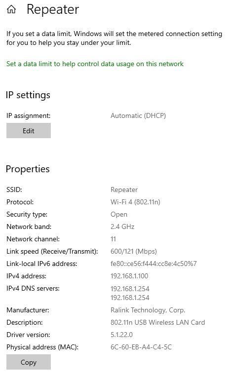

I've connected to the WS320 on my Windows 10 PC, and the attached info is what I can see.

That info seems to be about the WiFi adapter on your PC.... it shows that it is connected to the Repeater WiFi.
What would be helpful is to try to logon to the Repeater Web Interface and check how that is configured, I suspect that it is using the same IP address (192.168.1.254) as the Hub 2 router.  From a browser on the Windows PC connected to the Repeater if you enter the 192.168.1.254 in the address bar it should connect you to the Repeater Web user interface and allow you to access the repeater's configuration... if that doesn't work try the address 192.168.10.254 as initially suggested by @MisterW.
If the repeater is set up to use 192.168.1.254 as it's address this will be why you can't get access to the internet via the repeater.  If it does use this IP adrs then you can configure it another unused address or better still, if you can, set it to DHCP so that it will ask the Hub2 to give it an IP address that isn't in use.
