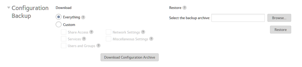

System/Settings/Configuration Backup ?
Re: How do I back up a Synology NAS?
@RobPN
"System/Settings/Configuration Backup ?"
Thinking about it, I'm sure I tried to use that many years ago after I had to factory reset the system, (IIRC, the anti-virus stopped updating), but it didn't restore. I assumed at the time that the backup I had made previously was corrupt.
I don't think that there is any way to test the validity of a backup, other than to try using it to restore the system - is there?
I have found what appears to be a backup config file from 2018, and I have just taken the opportunity to create another - but if they both let me down, at least I now have my screenshots if needed!

In case of disaster, how do I restore my NAS - either with all new drives, or indeed, with all new hardware if that would be different?
For the purpose of this discussion, we'll assume that I have recently backed up all of my shares to a USB Hard disk using Hyper Backup and backed up the configuration from Control Panel to the same USB hard drive.
What are the steps to get back to where I was with the NAS before the disaster struck?
Ian

@TheRoadCrew Thanks for the link. The method is very similar to some of the Synology knowledge base articles on how to migrate from an old Synology NAS to a new one.
A summary would seem to be:
Install DSM on the new NAS
Reload your configuration settings - (well some of them, some do not transfer)
Restore your data from the backup - (It's not clear to me whether the original storage pools and volumes are recreated - I think not)
Compare your old NAS and new NAS and then manually change any settings in the new NAS that have not been set by the migration process. (and install missing packages)
As in my "disaster recovery" scenario there is no working "old NAS" to compare with, it looks like I may need to resort to @Anonymous 's suggestion of a folder full of screenshots showing the current setup.
