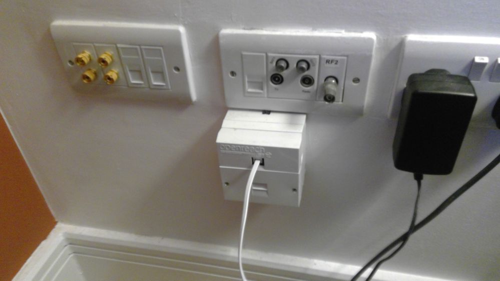

This is the sockets in the living room, the router works here.

It looks like the telephone socket in your office is an extension socket which isn’t wired up properly to the master socket if the router doesn’t work there. Personally I’d leave your router in your living room as fibre broadband works best from the master socket.

@jjjamie it looks like there are 2 ethernet sockets on the left hand panel in the living room. I would guess that these are wired point to point to other sockets. So presumably one is wired to the ethernet socket in the office and one to another socket somewhere else ?
Assuming I'm right, then you leave the router in the living room, you plug an ethernet(cat5/6)  patch cable from a lan port on the router into one of the sockets on the lh panel. Then plug a patch cable from the socket in the office to your pc.
Trial and error should tell you which socket on the lh panel is connected to the office and which to the other socket somewhere ?

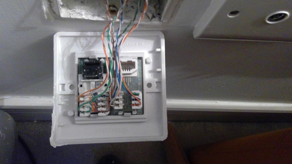

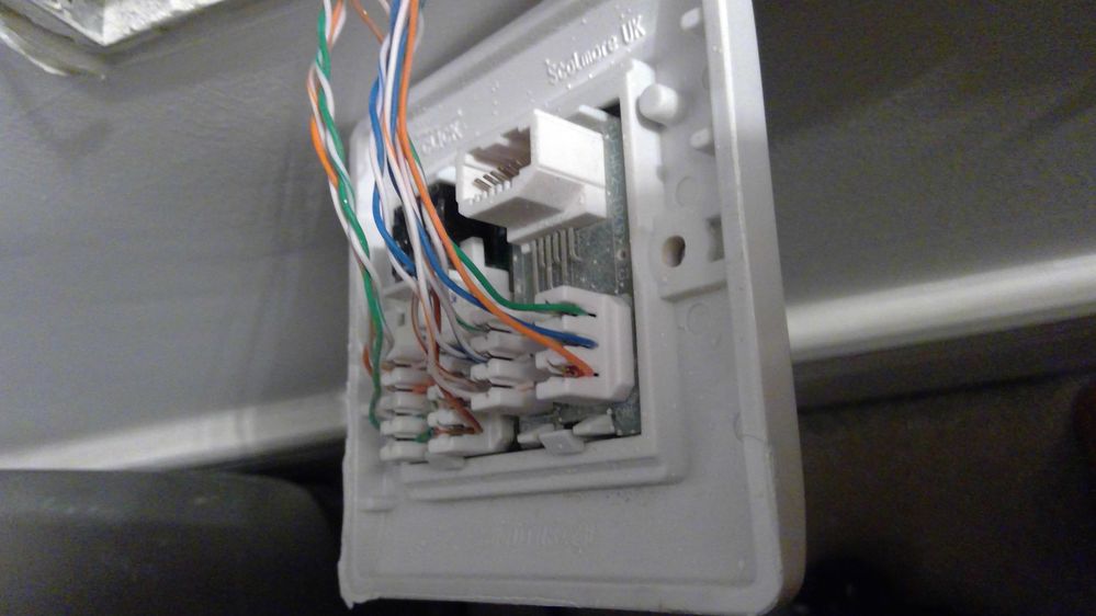

jjjamie
Posts: 19
Thanks: 3
Registered: ‎06-04-2021
Re: Ethernet / Network help
 @7up @Dan_the_Van
Could it be this?
