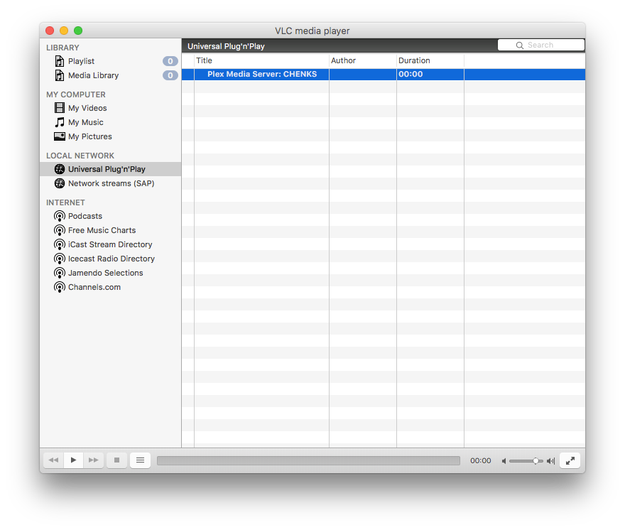

well i enabled DLNA on my plex server, and VLC has it listed

saying that though, although i could see the DLNA listed, i couldn't actually do anything with it. but that may be more to do with plex than anything else.
