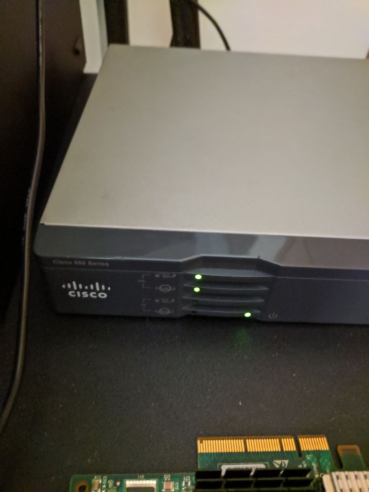

Also the PPP status light is that it's connected to both the "Link and ACT" lights, I was only getting the bottom light before I tried your config.

DSL Link Lights.

Also can you please include a nice clear picture of all the status lights on the front of the router so i can see what the status is.

Looks like the bottom lights are for the Gigabit Ethernet ports?
If both of your link lights are up on the top it looks positive for authentication at least, just seeing if you get that public IP
Re: Cisco 887VA or 897VA Router setup on Plusnet FTTC guide
10-10-2019 6:30 PM
I see just taken a look at the docs for your router and the bottom lights for the Gugabit WAN port so you can connect to the internet using RJ45 to a NTU or something similar.
You don't need to use this.
