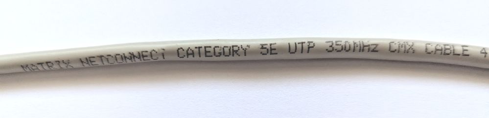

@Baldrick1,  @MisterW , @Anonymous  Should anyone be interested this is the outcome of my saga!
It seems not all cat5e cable is the same ?  Having changed the roughly 12mtrs of cable from my router to the access point in my loft (a TP Link Archer VR900 router) all is well and I get just over the 300Mb on WiFi 5 which is a noticeable increase in speed from my previous 74Mb contract.
Having removed the old cable (which had no kinks in it) I discovered a section with printing on it:
The Old CableThe Old Cable
The obvious difference between the old and the new is that the old is solid core whereas the new is multi stranded. I seem to recall from my far off student days that high frequencies travel on the surface of the wire core, a phenomenon called ‘skin effect’ and there is (or was) a type of wire called Litz wire for some high frequency applications, probably not relevant here but it is curious that the combined diameter of a single wire of the new cable when twisted together looks thinner than a single core of the old cable. To the naked eye the rate of twist on both cables looks the same.

@Batfrog solid core cable is designed for use in infrastructure cabling i.e fixed cabling between sockets and patch panels where the connections are made using IDC and punch tools. Braided is generally used for patch cables where RJ45 connectors are attached using crimp tools.
Maybe your solid core cable was CCA ( copper covered aluminium ) which can be a bit 'cheap and nasty'
As long as its designated cat5e it should be capable of 1Gb.
