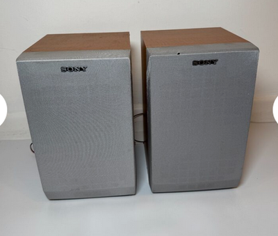

I would like to get a pair of "old style" wooden cabinet stereo speakers ( ex stereogram/stereo system ) like these
eBay item number:205216990742
stereo speakers 01.pngstereo speakers 02.pngstereo speakers 03.pngstereo speakers 04.png

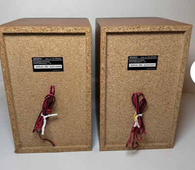

as you can see, they are rated at 4 ohms.
From doing a google about this, I think I will need an amplifier to plug in to the earphone socket, and then plug in/wire up/connect the speakers to the amplifier.
Otherwise, I am likely to damage the sound card on the laptop.
I do not want huge amounts of volume, just would like to listen to quality sound in the lounge, rather than having to walk around iwth bluetooth or RF headphones on.
Can anyone suggest a reasonably low cost amplifier that would suit this application.... the ASUS output impedence would remain, "as is" at 64 ohms.  so that, presumably, would be the "input" impedence to the amplifier.

I would expect your laptop output to effectively be designed to drive headphones, and fairly lightweight ones at that.
Any old HiFi amplifier that has a "phono" level input (typically labelled AUX) will almost certainly do the job, just don't use the turntable input if it has one as that's designed for much tinier signals from a vinyl cartridge.
You can also buy very cheap Bluetooth devices that plug into such an amplifier input (I have a tiny little rechargeable USB-powered one) so any source with a Bluetooth connection can play through it with needing cables.

My only thoughts about your audio needs @shutter is that if you're after "old school" speakers an "old school" amplifier might be needed to give the bass output you're after.
Many modern amplifier systems are built assuming a separate and separately-powered single bass unit.
