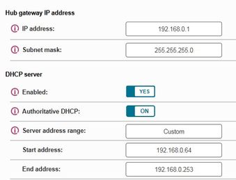

It worked for me
My order using wireless which is not really recommended
1) Clicked on the Server address range box and selected Custom
2) Clicked on Start address made 192.168.0.64
3) Clicked on End address made 192.168.0.253
4) Clicked on IP address made 192.168.0.1
5) Saved.
6) Disconnected the wireless connection - waited 30 seconds and reconnected

Pressing the server address range  192.168.1.64-253 brings up the red popup box. After selecting the correct range it goes red background. Then Pressing custom button - it does nothing! Nothing can be edited within any scenario!
I think you're adding an step that's not required.
What if you follow my steps?

If you look at my other uploaded file,I never see start and end addresses on separate lines like your image displayed. It's different. Clicking on the address range box (on a single line) on mine brings up the popup. No editing allowed.

When you click on the address range box, you select ->Custom -->Set
the Start and End boxes should then appear.

Thank you all.  Following your instructions more precisely I did manage to change it to 192.168.0.1-xxx system. There is one outstanding issue. Before,when I connected I seem to get in the router with no warnings.

A couple of answers, a PPPoE connection does not prevent the change from being made, the options to change the IPv4 settings are not available unless in Advanced settings.
