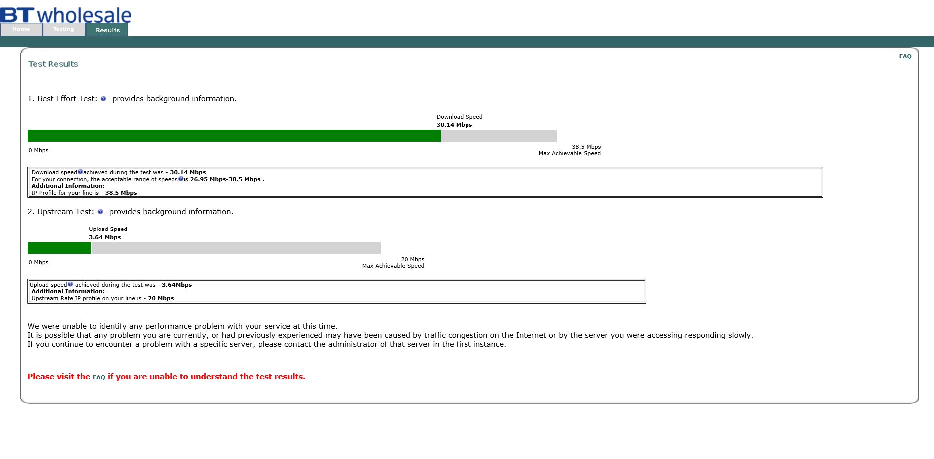

Re: So far so bad...
I see my IP Profile has reset itself back to 1750 as well..  Sad
Download speedachieved during the test was - 1700 Kbps
For your connection, the acceptable range of speedsis 800-2000 Kbps.
Additional Information:
Your DSL Connection Rate :2270 Kbps(DOWN-STREAM), 444 Kbps(UP-STREAM)
IP Profile for your line is - 1750 Kbps
