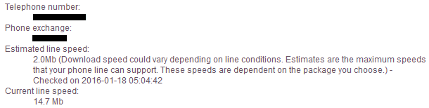

Portal > Data > Transfer Speed - Says that my estimated line speed is 2mb, very useful...total madness.
I can clearly see that it's being restricted, because the downstream attainable rate on the line is a lot higher (22284) than the actual given sync rate, that's one of hell of a margin?, that's a difference of 2393, surely that can't be right?, now I'm no broadband expert by any stretch of the imagination, but it look's as if the line is still pretty much capable of dishing out the same speed as the TalkTalk connection did beforehand?
