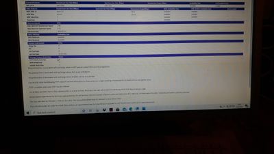

Might not be much help, and I totally understand your frustration, but if you post a screenshot of the result of running this link: https://www.broadbandchecker.btwholesale.com/#/ADSL - making sure to obscure/remove your phone number, it would be useful.
Chelsea08
Posts: 5
Registered: ‎24-11-2015
Re: Mis-sold unavailable Plusnet Fibre.
Thank you for all of the replies I have received. I am very grateful for all of the support and excellent advice I have received from members of the Forum. Since I posted the comments Plusnet has been in touch but I have not yet spoken to them again but will do on Monday.. I have posted a screen shot of the Broadband checker for my home phone number that a member of the Forum recommended I run and it is below. I don't really understand what it means? Thank you.

@Chelsea08 Looking at your photograph - which would be much easier to see if you had actually posted a screenshot - it appears that you can only get either (a) a low-quality, low speed over the ADSL network or (b) a fast (but very expensive) FTTP, I am not going to comment further, but I'm sure @Townman will pick this up fairly soon and be able to explain the options, or his take on the information.
Just out of curiosity, roughly where do you live - out in the country, or in an urban area (the first part of your postcode might help here).

@Chelsea08
Not a screenshot as such, more a photo of your screen, so slightly harder to read.  Wink
But I can see that it says you have FTTP available to you (also "OH feed with no anticipated issues" is stated) and not FTTC, so therefore PlusNet under their present policy of 'not being able to supply FTTP' (other than to some of us on their 'now-closed-to-new-entrants-trial') will not be able to provide you with any type of fibre-based connection.
ISTM that PN ought to perform some sort of about face and put things right for you as you have indeed been misled.  One likely outcome might be to release you from your contract without penalty which would allow you to obtain a FTTP connection from another supplier.
Good luck.

You could well be right there, @RobPN , but I wonder if the OPs reply to my post above might shed a little more light?

@jab1  why do you say expensive? FTTC and FTTP tend to be similar in price for the same speed band.

@Mustrum Because the 'available product' looks to be a little different to what my availability check shows - but maybe I'm misreading, in which case I apologise. I have no chance of FTTP for the foreseeable future , so don't have any way of checking the pricing.

@jab1  I believe it shows  WBC FTTP, not FTTP on Demand, which is the expensive one.
It certainly seems a clear case of being miss sold, I certainly hope PN does the right thing and allows a release of contract, and adds in some competition - at the very least cover any migration costs. EE now does FTTP, so at least an opportunity to keep things in the same family without the extra costs BT would charge.
