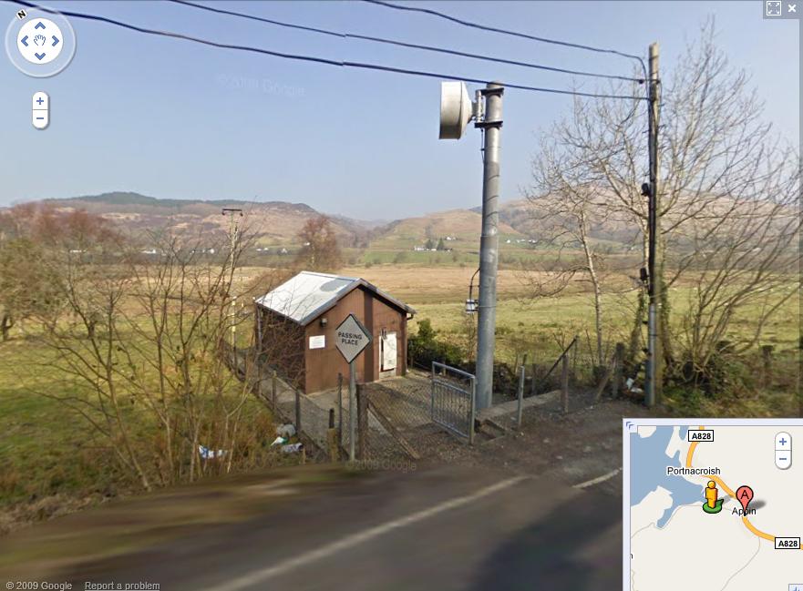

was near this exchange on Holiday, got good Synch speed, very few residents, no LLU, and definitely no resident openreach
