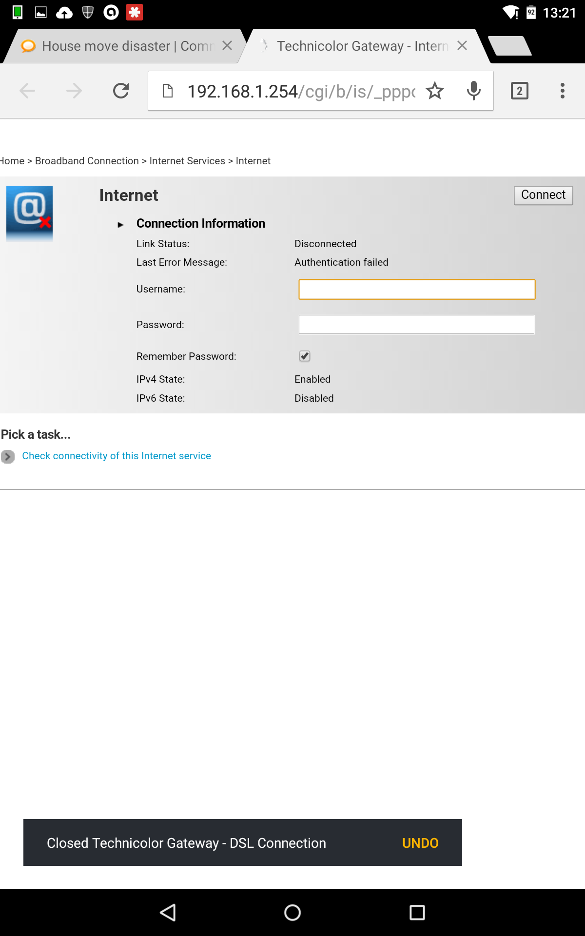

Now, the two links you asked about, I can attach screenshots from my Nexus 7, I hope that's okay for this.

EXCELLENT!!!
Indeed perfect!
From what you have posted, I do not understand why the CSC agent has requested an engineer, but I do not know everything!  I wish my line was as good as your line - you have perfect synch for a 20CN service.
Your problem is getting the PPP session established.
Explanation - There are two "links" involved in connecting a user to the internet...
SYNCH - depending on your product that is ADSL or VDSL hence the reference to xDSL.  If you have "synch" to the exchange xDSL is said to be "up".  You have perfect synch and zero error rates.
PPP - this a "virtual" connection between your router and your ISP - in this case PlusNet.  This is how your router "logons onto" PlusNet.  Did you notice the "Authentication Failure" message?
On the screen you posted, you need to put plusnetaccountname.plusdsl.net into the user name field and your account password in the other, then click connect.
I'm going to see if I can get CRT to poke this issue.  Please post back if you are successful in connecting.

Alright! Brownie points for me!  Cool
I have put in my username and password countless times in the last few days but to no avail  Undecided it refuses to connect. The 3rd screenshot shows what happens after I've applied my username and password, nothing  Sad it says 'retrying' but nothing happens and it certainly doesn't connect.
