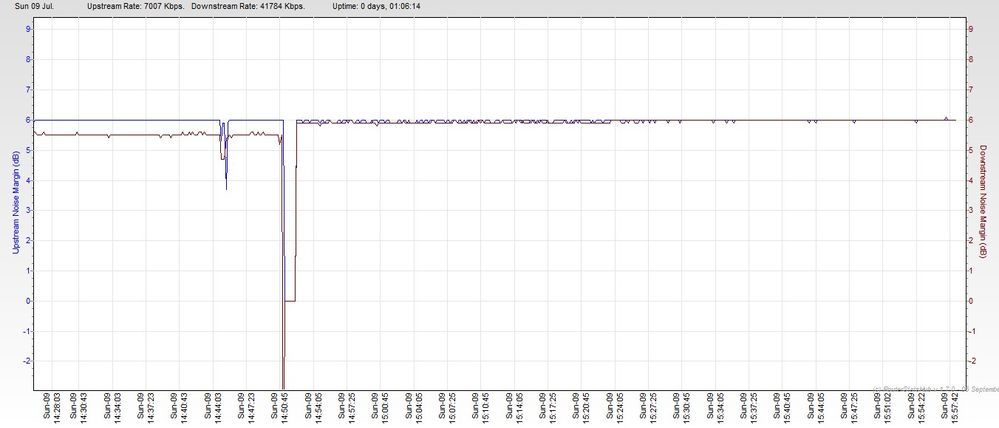

Hi Steve,
I'm back at the PC and have done a detailed look through the graphs you've provided. Here's my thoughts on th e(thus far) limited information available.
Sat 14:25
- SNRM transition 6dB -> 7dB suggests that some source of RFI stopped
- SNRM transition 7dB -> 4.8dB suggests some source of RFI started, but worse than before
- Note the corresponding changes in the max (theoretical) rates, HOWEVER there is no change in synch rate implying these events did not drop line synch
Sat 15:45
- SNRM crashes loosing DSL synch
- SNRM 'returns to 6dB (line resynchs at the TARGET SNRM) at a slower speed than before
- Note how flat the SNRM is after this
Sat 17:20
- SNRM crashes again
- Resynch is very slightly faster
Sat 17:45
- SNRM crashes quite badly (-2dB or less)
- DSL resynch is slightly slower
Though there are few data points from which to draw firm conclusions, I am struck by the close time correlations - 20 ish and 45 minutes after the hour - this is worth watching for.

I suggest that you keep RS running - 10 second sample rate - 720 points to a graph - timed capture - will give good granularity to events, keep the graphs covering a 2 hour period and save them all in the RS directory. I think it is worth doing a few days of this monitoring before invoking further assistance from PN / BT. If the line is still unstable, you'll need good evidence and these RS graphs will help to provide that. One problem that repeatedly crops up in circumstances such as this is that the cause of the intermittent disconnects is never manifest when the engineers attend!

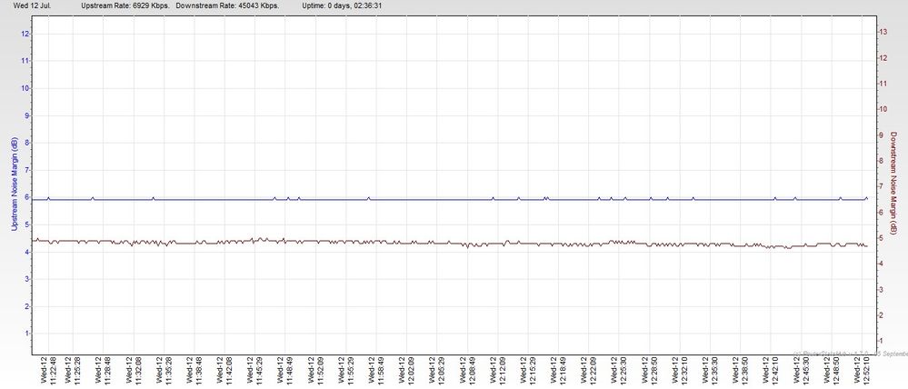

Down Noise margin slowly decreased with the sync holding at 44000 Kbps. Got down to 3.8 and stayed solid for most of a day then spiked up past 6, then disconnected.
Yesterday the Noise marging was 4.8 then it spiked up to 6, dropped to 3 and disconnected. When it reconnected it connected with a noise margin of 5dB and a speed of 42.6. At 19:40 last night it spiked to 7 and then back down to 5.8 (with no disconnect) and is now sitting at 5.9
I'm getting more disconnects than I used to do.

Noise margin has dropped with no disconnects - I there are spikes to values like 7 or 8 which sometimes have a line drop after them and sometimes dont. As the line can apparently hold a 44Kbps connection (which is right at the limit of the line) and give me download speeds just about on 40 at 3.8Db.
The sudden drops and spikes have no pattern to them
I'm seeing drops when there is no sudden change in margin.
I've got the graphs
