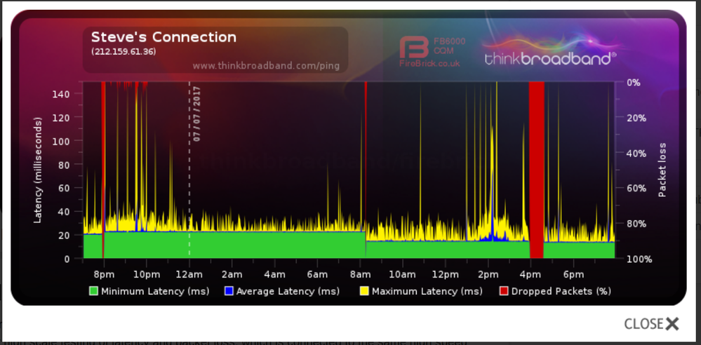

Interestingly enough we were watching something on the NOW App on the Youview Box and it didn't even notice any of these 2+ minute disconnects....so it obviously has a very large buffer!
Posts: 28,818
Thanks: 13,017
Fixes: 241
Re: Five months.....
Connection stability such as this rather points to an intermittent line fault or REIN.

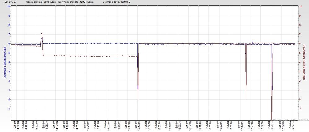

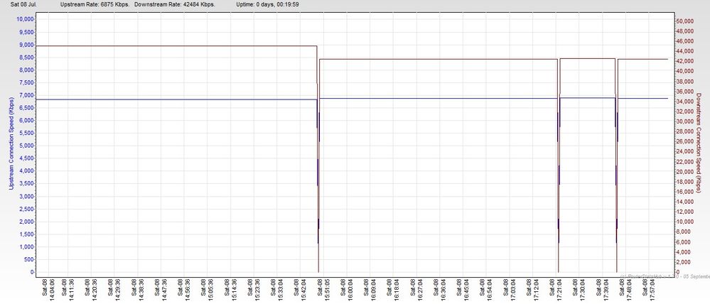

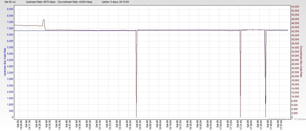

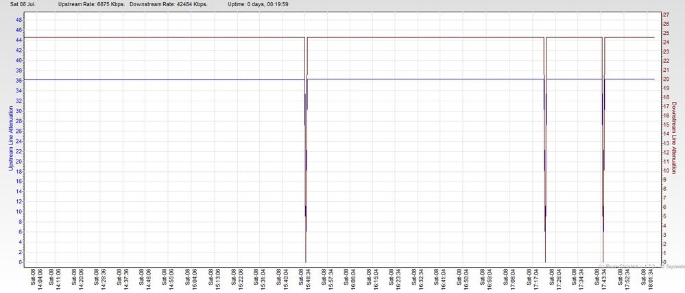

Router stats is running .... there was quite a drop for a while before the first disconnect... and no I've no idea what the spike up to 7 is at the start of the graph. And I've no idea why the SNR recovers when the line drops for the first time.
Line has traditionally been stable. When I've had drops before they've usually lasted a few seconds between PPPoE going down and coming back up. Now they take 2 to 3 minutes.

Posts: 28,818
Thanks: 13,017
Fixes: 241
Beautiful!
This does look
Like RFI - some spike switching event. The reason the the SNRM 'recovers' is that it sets to the TARGET for the line at a slower synch speed.
What's the sample interval? 10 seconds is really good for detailing the transgressions. Keep up the monitoring and see if you can correlate the drops with the use of electrical equipment - CH / fridge / freezer / lighting going on / off.
Will look at this again when I'm next on my PC.
Its what ever the default is set to..... which was 30 seconds so I've put it down to 10.
There is no correlation and the Hub 1 is powered from a large mains filter  .. nothing has changed in the house and since yesterday its been stable (I've had it go several weeks without dropping and even with all the engineer visits and things going on its usually at least 5 days between drops) .
Does the PTM over DSL going down have any significance or is that just part of the PPPoE stack going down?
It would be interesting to know if anyone else on Cabinet 84 in Cheltenham is having similar issues

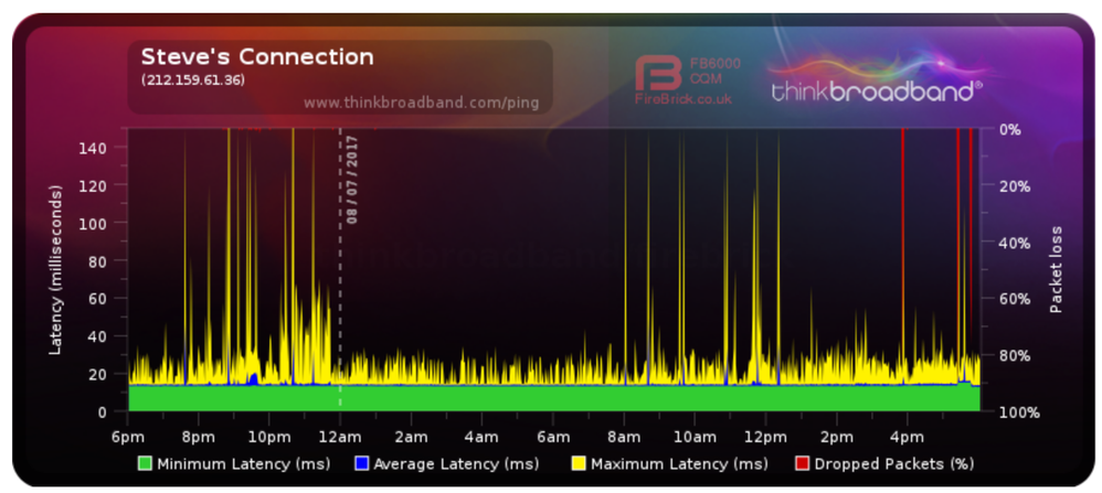

As part of the investigation in to packet loss and multi-cast break up I've actually had everything in the house turned off apart from the router, Youview box, TV and laptop. So if it is RFI then its coming from somewhere else.

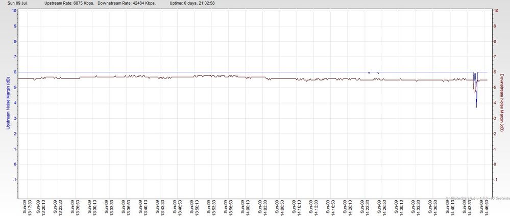

This is what the SNR normally looks like (this is the last hour and a bit):
I also find the jump to 7 towards the start odd - that would imply that something got significantly better on my line for a very short while....

The Master socket (which has been replaced twice) is broken - the clips on one side don't work so the whole thing can wobble which means I can do this just by touching it :
