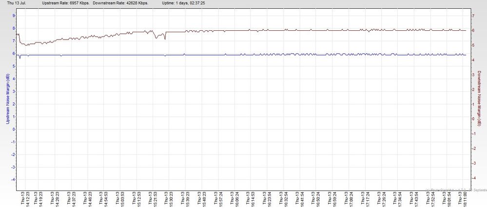

Been monitoring it on and off since the start - and its just wobble along between 5.5 and about 6.1 :
Back in FebBack in FebOddly enough since removing the master socket front plate:
So using the filter provided with the Hub 1 gives a much less wobbly Down SNR

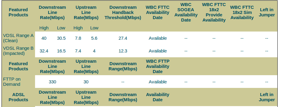

Could be - the line back to the cab is somewhere between 700 and 900 metres with the last 50 metres or so overhead from a pole. From the pole to the Master socket the wiring is less than 14 years old but I suspect the pole to the cab dates back to when the houses were built in about 1971.
The line is syncing about as fast as BT say it can:
So I'm quite happy with all of that.

Spike up - no disconnectSpike up - no disconnectSpike up then down then dropSpike up then down then dropMargin down and then slow rise no dropMargin down and then slow rise no drop
But Ive also had this:
low noise margin, good connnect speed and stable connectionlow noise margin, good connnect speed and stable connection
But the sudden increase in random drops (not always associated with Noise Margin changes) is annoying

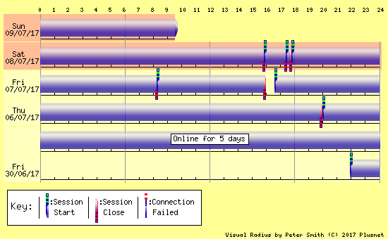

Been away for 4 days.
According to wife there have been multiple disconnects.
SyFy is currently just about unwatchable.
I have had enough...  I will be cancelling my TV subscription tomorrow and expecting some compensation from Plusnet as I've been paying for this service and for the past 6 months I've had problems. I've had to take half days from work to be in for engineers who have criticised previous engineers, complained about the external wiring, have said paperwork has to be raised and then haven't done it ( causing yet another engineer visit) or just haven't turned up. The problem isn't directly with the TV service but I might as well save myself some money whilst I look around for a new ISP.
Noise Margin Graph:
