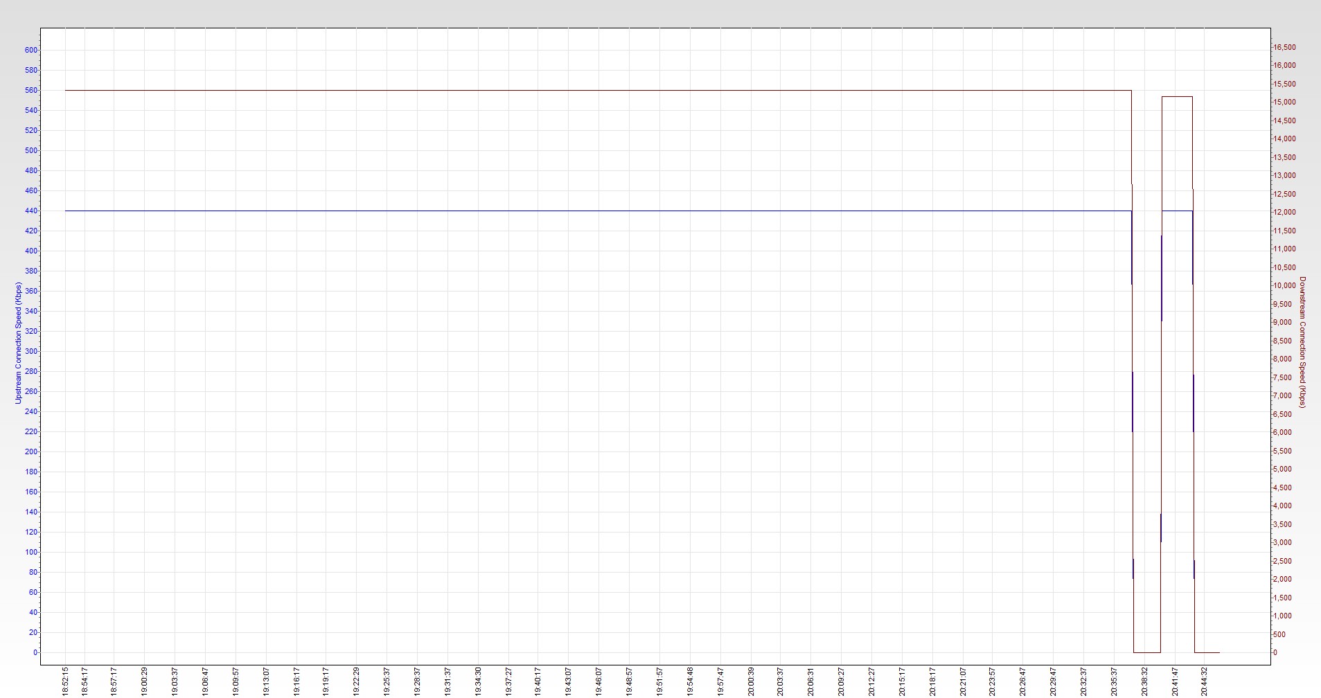

The connection speed graph dropping down to zero, then at the next sample going back up to the same speed as it was before - isn't that more likely to be due to the stats program failing to collect the data?

I am not aware of any characteristic problems with BT HomeHubs.
The upwards spikes on the upstream SNRM graph seem so unusual I am very doubtful that they are representative of the actual SNRM. Thinking about it, the SNRM is actually measured on the end receiving the signal. So for the upstream, it's measured by the equipment at the exchange and the values reported back to your modem.
I also remembered that the connection speed can actually be momentarily reported as zero by some modem/routers, without dropping the DSL, when there's a large burst of noise such as a flash of lightning during a thunderstorm. But in any case, a momentary burst of noise affecting the DSL would not affect the usability of the Internet connection for 15 minutes or an hour as reported in the opening post of this thread. Ping responses of 1 second can't be explained by SNRM blips either.

Looking in more detail at the graphs - the large spikes on the Upstream noise - first those spikes down appear to be exactly the same value each time, and the spikes up appear to be one of two (close) values each time (might be able to confirm that from the RS log).
My inclination, also noting the comment by ejs, is that these could well be some data gathering issue.
As mentioned by Townman, we don't have experience with how RS works with HHs, but as also mentioned RS can have other data gathering issues when the graphs will drop to zero momentarily - this often occurs when your computer CPU has very high or 100% usage on other tasks.
You can usually confirm these instances by looking at both the SNRM and Sync speed graphs where the drops will be simultaneous and the sync speed plot then carries on with no change of speed.
In cases of a real loss of sync it's very unusual for the sync on both US and DS to resync at exactly the same previous speeds and the gap will be longer because of the time taken to resync.
Don't despair with these bugs, a lot of monitoring tools have pluses and minuses. The RSHub uses a different engine from the other versions, so we aren't familiar with it. Is it possible to plot any of the sync speeds on the same graphs as the SNRM? A right click on the graph usually shows the options (I haven't read the Help for the HH version).

I have attached the last noise graph (PS12.jpg) from RS from this morning - it seems that once the connection dropped, RS decided it wouldn't save the graphs any longer, although it was still running in the background, just with nothing on-screen, assuming because it was all offline.
If I 'scroll' back in RS, the noise graph is completely blank, but if I scroll back on the connection speed, it shows PS13.jpg.
It seems that this morning, the connection was still displaying as online according to the RS logs, but of course, there was no connection - also not sure as to why RS stopped saving the image graphs at this point.  It is interesting to compare the RS logs with the HH logs, that seem to cycle showing a DSL issue.

Hi Ian, I assume from what you've said that there's no matching SNRM graph to PS13 which is odd.
A bug with the non-HH version of RS often shows 0 on the plots & logs for everything except Uptime and Attenuation if for some reason it stops plotting properly. The usual cure is to press the black Stop/Pause button and then straight away press the Green Start Arrow button. Sometimes it restarts at some random time later by itself.

Just an update with graphs from this afternoon/evening - This last incident is rather extended compared to normal.
Anotherone - the HH version of RS doesn't seem to have the option to reboot the router if it shows downtime - you actually have to navigate manually to the connection page within the app to get the stats running - seems oldschool Smiley
The issue with the connection in the morning was spotted by my mother when she realised there was no internet access at 4:45AM (what was she doing up so early!? Smiley )
The end of the WAN log where it reads 'Limit of wan log' is in the HH itself - It would appear that it had so many of those repetitive logs every couple of seconds/minutes that it ran out of flash space!

I've never known "session close being generated somewhere in the BT Infrastructure?" to ever have happened. When the "backhaul" or other parts of the network are taken down for maintenance, it just goes down. Depending on the precise way it went down, in quite a few instances, it has required a reboot to get a connection established again - I've experienced that with a few different modem/routers (all BCM based FYI but not necessarily relevant).
To repeat, the "Plots" do NOT indicate "graceful PPP session closures".
Nor do they necessarily indicate a loss of sync, and conversely there can be losses of sync without there being a loss of PPP session when sync has been lost by the momentary loss of US sync and then sync being re-established.
Quote from: Townman
"Do the records point to a cause?"
"Is there evidence of associated resynchs?"
A PPP drop without a loss of synch rather points away from a line issue, but I do not know where - and you might need to get the engineer to think about that too!
Kevin
I don't know what additional "evidence" Ian may have, but I'd guess from his "remoteness" to the connection and from what he has posted, including his comments, there's probably not much more. Most of it is based on his mother's and his own experience with the connection using a variety of modem/routers.
As I pointed out in reply #37, the WAN log and sync speeds in the RS log (as well as the graphs) show changes in sync speed and so quite obviously  losses of sync.
Also as I pointed out in reply #37, the problems associated with establishing a PPP session as well as the sync issue suggest an exchange problem or with the specifics in this recent example, a problem with the HH3. However, I'm very mindful of the fact that problems were seen with the other modem/routers and therefore inclined to suspect the fault lies at the exchange.
@ian
I'd guess you are unlikely to be present when the engineer comes, so it would be best to ensure that your mother makes it crystal clear to the engineer that the problems with not being able to browse have been seen with 4 different modem/routers and the most recent evidence shows a problem not being able to get a PPP session established even when there hasn't been sync loss which also occurs.
IMHO, a full Lift and Shift is what should be tried (but depending on when the engineer is coming a Port reset - remote job - could be tried first to see if it solves things).
Edit: I guess I could have made it clearer in terms of additional evidence Plusnet will have PPP/Radius logs as well as Delta Reports & xDSL status checks. My brain is a bit addled with other issues at the moment but there's other info you can get from KBD.

Anotherone,
Yes, I'm sure that all of your answers are right (no I'm not being sarcastic).  Anyone not knowing about the radius plot gremlins (for example the OP) might have miss used the latest plot.  Indeed I wonder just how many of the PlusNET support staff are aware of this issue?  The question to CRT (whenever answered) is a prompt for a reflection on the potential to mis read a diagnostics report by which a great deal of "store" is made.  Further I took the opportunity to ask them to clarify exactly what it is really reporting.  Any non-graceful loss of PPP ought to be reported as a connection fail, I think you'll agree that the evidence suggests this is not the case.  I have noted with more than passing interest the implication in another thread (will discuss with you later) that a billion router is handling PPP session loss AFTER xDSL resynch.  Possliby out of my tree, but I'm led to muse if it possible to pass a PPP session close after a resynch?
A diagnostic tool reporting the wrong information can be worse than do diagnostics tool at all.  Such matters need to be recognised and where diagnostic reports are misleading due to known issues, that should be made plain when referencing flawed reports.
As for the questions, may be I could have made it a bit more clear - they were intended to be probing questions which might be asked of the BT engineer, not of Ian.  Sorry if I confused matters with you.
Kevin

AFAIK the Vis.Rad was designed to be a simple graphical tool to show whether a PPP session was present or not, when a session started and when one ended. I think you as trying to read more into what it currently gives. I'm not clear though, on when the "Connection Failed" flag is designed to appear and the above VR is one of the few where I've seen it crop up, but certainly not as many times as on that one Shocked
It should also be noted that in a lot of instances the drop shown on the VR is also accompanied by a loss of sync, but not always and further data should be checked.
Quote from: Townman
That is certainly a very valid point, but it's been raised before but I don't see any evidence that indicates things have changed by en large. On too many occasions losses of sync have not been checked because the VR hasn't shown a drop. As I mentioned in a previous post eg., if the loss in sync is due to an initial loss of upstream sync and the US & DS sync is re-established well within normal sync times, then there's usually no loss of PPP session and hence no change of IP address or change of Gateway. Too many inexperienced CSC agents do not check things like Delta reports etc to see if sync was lost when a user has reported drops in connection. I'm not suggesting that has been happening here - insufficient evidence.
(I look forward to hearing about the billion elsewhere).
