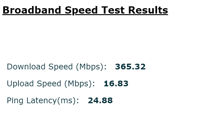

Indeed @rongtw
This is my latest (I'm not on G.fast yet!)
Ye cannae change the laws of physics!Ye cannae change the laws of physics!
