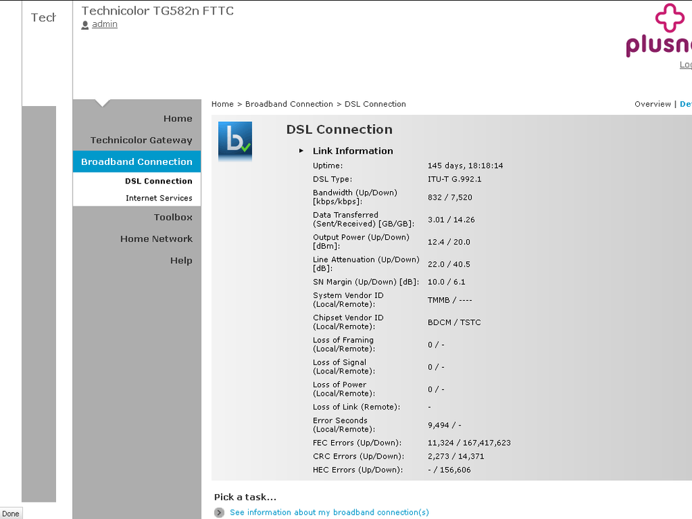

Be blowed if I can find stuff atm Embarrassed but anyway, I think this is the right link -
http://192.168.1.254/cgi/b/dsl/dt/?ce=1&be=0&l0=1&l1=0 click on that and you'll be prompted to login to the TG582n, default name is admin and the password is the serial number beginning CPxxxx (and don't post that on an open forum). If that doesn't get to a page looking similar to the image below, then http://192.168.1.254/cgi/b/dsl/dt/?be=0&l0=2&l1=0 should.
You can just copy/paste your stats into a post, and it'll look something like

If you click this link https://portal.plus.net/my.html?action=data_transfer_speed to get your Current Line speed (Login required) - don't post your phone number. Copy and paste that.

http://192.168.1.254/cgi/b/dsl/dt/?be=0&l0=2&l1=0 should definitely get you the stats if that's a TG582n, you get the login screen first mind.
If that's not working, can you post a screen shot of what you get when you just got to 192.168.1.254 please.
