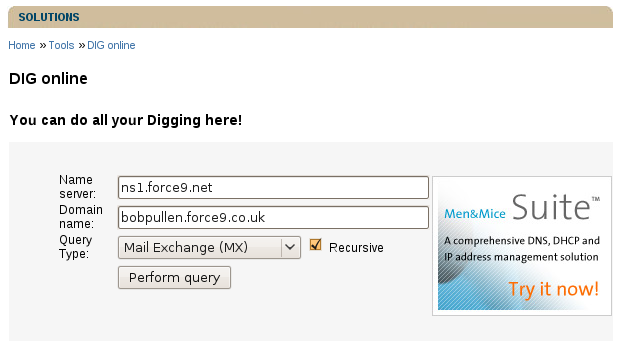

Another method, is to perform a DNS Lookup to see what servers are responsible for handling email for your username or domain. This can be done using the DIG command in Unix or the NSLookup command in Windows. You can also do this using an online DNS lookup service like the one here. Enter ns1.force9.net for the Name server and Under Domain name enter the bit after the ‘@‘ sign of your email address. Select Mail Exchange (MX) from the drop-down below and click Perform Query. What you are looking for are the names of the servers that are handling your email. If you haven’t been migrated yet and you have spam filtering switched on then these will be Postini's servers and the output will look something like this: This is what the output looks like if you have been migrated and have spam filtering switched on: If the output looks like the example below then you have spam filtering switched off. Switch it on by visiting the Manage My Mail tool in the Member Centre.
