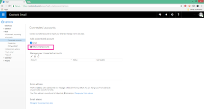

1. Once you’ve created your new email address, log in and click on the cog icon in the right hand corner, and select ‘Connected accounts’ from the drop-down.
Connect your accountsConnect your accounts
2. In the next screen, click on Other email accounts under Add a connected account.
Other email accountsOther email accounts

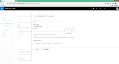

3. In the next window, type in your name, Vodafone/Justmail/Plusnet etc email address and password. You can choose whether you want Outlook to create a new folder for your emails, or to import any existing folders you already have.
Import existing emailsImport existing emails

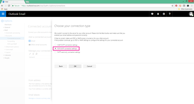

4. Next, make sure to select POP (Post Office Protocol) /SMTP (Simple Mail Transfer Protocol) connection settings, and click Ok.
Connection settingsConnection settings

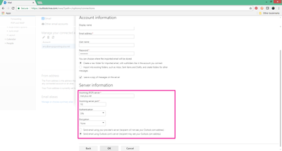

5. On this last screen, there are a few important details to fill in. Add in your Justmail/Plusnet/Vodafone etc email account details as before, and then under Server Information enter the following details:
Incoming (POP) server:
• Freeonline: mail.free-online.net
• Force9: mail.force9.net
• Madasafish: mail.madasafish.com
• Metronet: mail.metronet.co.uk
• Plusnet: mail.plus.net
• Vodafone: pop3.vodafoneathome.co.uk
Incoming server port: 110
Authentification: SPA
Encryption: None
Finally, make sure to select ‘Send email using Outlook server (recipient may see your Outlook.com address) before clicking Ok.Input server informationInput server information
