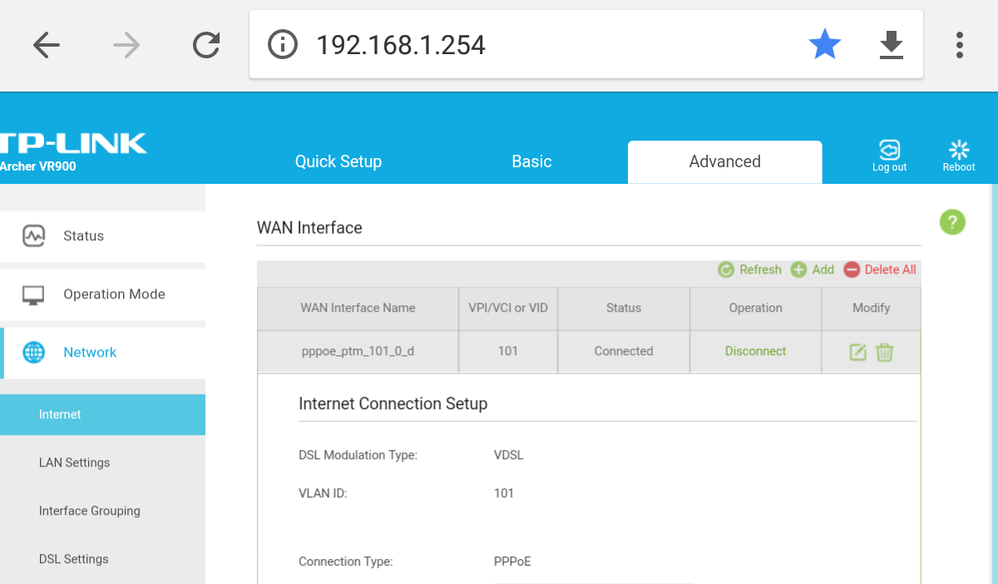

Re: xDSL synchronisation issue with TP Link Archer VR900
Probably is, but is the VLAN ID for the WAN connection set to 101?
