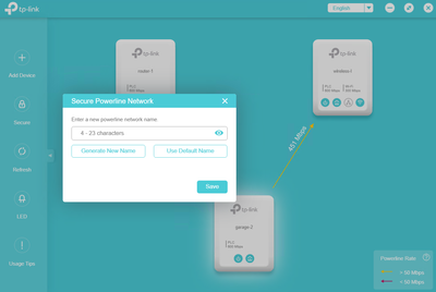

I thought TL-PA4010 are powerline adapters, are you usingWPA4220 Wi-Fi extenders as well?
Are they all using the same network name as this will cause them not to connect to each other and the Hub, I use the tpPLC to set that, select Secure. Make sure the devices are registered first.
