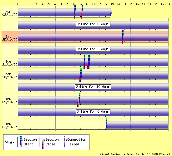

I have run a line test for you and found a fault on the line, which may require an appointment for us to resolve. We would need to run a couple of checks on the phone. If you could reach out to our technical team, they will be able to run some checks with you.
Unfortnuatley, I am tied up in other areas at the moment so I am unable to give you a call right now Sad
@Townman
I have provided a visual radius graph of the last 30 days

Josh - you are an utter star ... thank you!  This points in the right direction to find a remedy.
⭐‌:star:‌:star:‌:star:
@yorkshiregeek
Do those disconnection times look like when you were 'fiddling' or do they relate to when you encountered issues?
Can you please check your tickets (see the link below) and respond as appropriate ... or can you please ask your wife to engage with the support desk.
