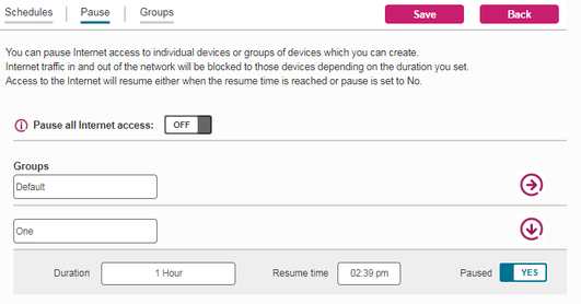

@Anonymous
With pause you have the option to pause everything or a group of devices.
So do you have a group with just one device or many? I have set up a group named 'One' with a single PC in
Looking at >Access control >Groups I see
Looking at >Access control >Pause I see with the device paused.
With the device in the group when pause I see >Home >My devices
Paused
Not paused
You need to click save for every change you make.
HTH
