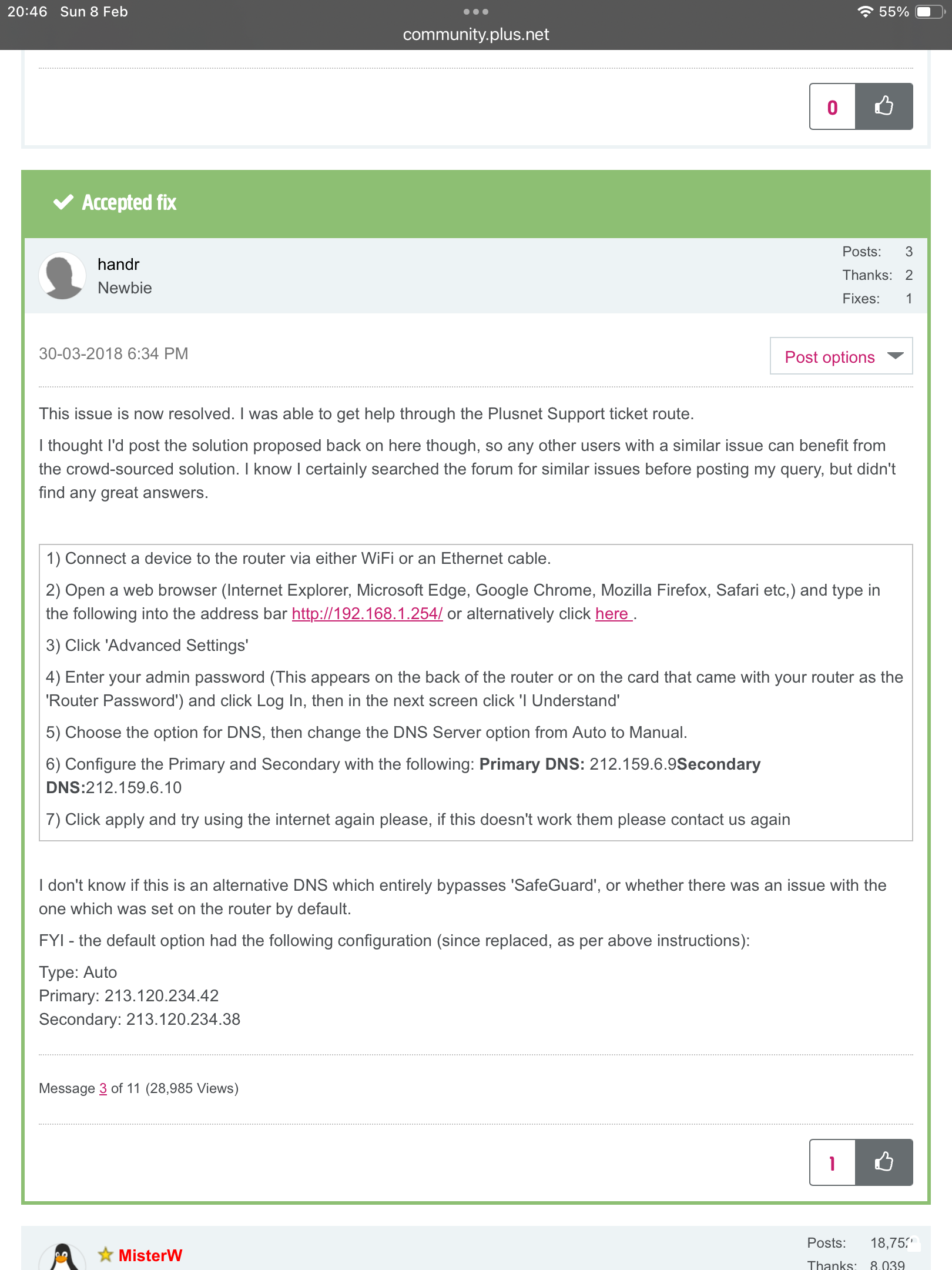

Hi! Many thanks for your help - I did have safeguard, then thought that had caused the issue and promptly deactivated it and reset everything.  I thought I had solve the problem for about a day as everything went back to normal but then the day after it started up again.  It still says 'inactive' but I have my suspicions...(see attached).  I am going to take my router to my dad's house as you suggest because it's the only way of proving it's something on the router as you say.  I shall report back once I have tried this out.  I am also thinking of getting a TP link router and forgetting about the Hub 2 - any recommendations?

The "SafeGuard" service "lives" in Plusnet's network and is asscociated with your account, so if your router moves to another location with a Plusnet service, it will (I think) register as you and pick up your account including safeguard service.
SafeGuard doesn't "live" in your router but (say) a TP-Link product would let you set a different DNS provider which would disable SafeGuard. OpenDNS is a possibility as is the Google DNS service.
In this case, an eBay purchase of something like the Archer AX55 AX3000 could be a reasonable choice and there seems to be a ready market so if it's not an improvement you could sell it again!
I'm not the best person to advise on TP-Link products although I've had some a while back and was very impressed with their support.
I don't think your screenshot shows things you have activated, just what's available (so it says Activate Add-On).

I see, thanks for that. I checked and the Safeguard is 'inactive' according to Plusnet.  I've also tried disabling the firewall and that didn't help either....I note there are instructions on the Plusnet help site saying there are Broadband firewall settings in 'connection settings' but there aren't....there is mention of low, medium and high, but all I have in the router menu is default, block all and disabled.
PPPNetPlus
Posts: 8
Registered: ‎30-08-2025
Re: iPhone 14 apps not working
So.....I eventually managed to get back into Member Centre and the add-on section using a 5G connection and low and behold my Safeguard was back to 'ON' - I never did this??? So I turned it back off and it said 'unable to save settings, try later'....
I went back in. (again on 5G) and used a different browser which said it was now 'OFF' - restarted router and now I can use Whatsapp and signal again.... Now I guess i wait to see if it switches itself back 'on' again????
PLUSNET - can you please sort this out? Not sure how useful this feature is to anyone if it stops the most popular messaging apps working???
Thanks for all who helped me out with their input, much appreciated

Posts: 20,039
Thanks: 8,996
Fixes: 579
@markhawkin
f you can get another router (even to borrow) that isn't one supplied by a broadband provider that's well worth a try as I suspect changing to a different DNS provider would at least hide the problem.
No need for another router, the DNS settings can be changed on the Hub 2
@PPPNetPlus
To change the DNS server settings on the Hub2
Go into Advanced Settings, then "My Network". Click on the IPv4 tab, and go down to DNS Servers. Click on the Auto button so it says "No", then enter you desired DNS servers in the "Primary DNS" and Secondary DNS boxes.
For example enter "8.8.8.8" and "8.8.4.4". for Google DNS
Then reboot the router. All your devices are likely to need a reboot to get the to use the new settings.
Posts: 4,959
Thanks: 3,252
Fixes: 147
@PPPNetPlus
A random thought is the Hub two showing the correct broadband username for your account?
Navigate http://192.168.1.254  ->Home -->Advanced settings --->Technical log look for line "Broadband username:"
To confirm if Safeguard is enabled/disabled on your account navigate ->Home -->Status
If safeguard is enabled you will see these IP Addresses in the Primary and Secondary DNS line:
213.120.234.38 and 213.120.234.42
If you add DNS hosts as described by @MisterW they will override the account based DNS host settings.
