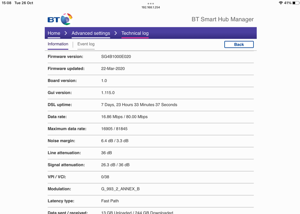

Hi everyone, I hope you’re all well.
I’ve been happily using a residential BT Home/Smart Hub 6 Type A for a couple of years with Fibre Extra and it’s performed incredibly well, I have a very stable line. As you know this Hub resets after 14 days and when it’s done that my Downstream Sync Speed has always been around 70 Mbps however, after the latest reset it has gone right up to 80.00 Mbps, dead. This hasn’t resulted in actual faster speeds though, I’m still getting a very good 63 Mbps, which is very usual for my line.
Does anyone perhaps know why the Downstream Sync Speed set itself at 80.00Mbps, it’s never done that in the 2 years I’ve been using it.  Many Thanks.

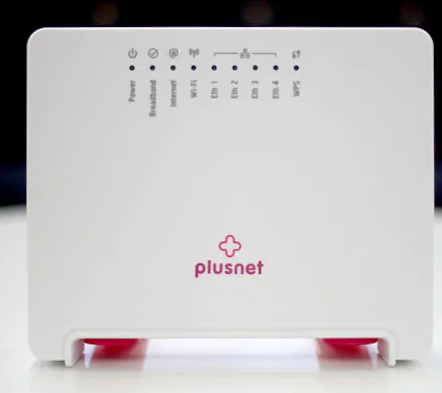

I also look after my mother-in-law's broad band and this shows similar wireless connection issues that I had. When I initially got broadband from plus net, we didn't know if she would really use it and thus got the standard broadband package. This uses a different router which I believe is called a hub zero (is that correct?) and looks like this:
I am wondering if I can do the same mod, i.e. get a HH6 second hand and replace this router as I did with my one? Does it work the same? Is there maybe a different help page like this explaining which other BT one to get off ebay? Maybe I need to upgrade the plus net package first then do it, although she doesn't need the speed/bandwidth of fibre just a stable wireless connection.

@keithscarfe
In case there's any confusion the simple answer is Yes, you can use any Smarthub on an ADSL connection in place of a Hub Zero in exactly the same way.
The only addition I would make to this statement in case this post is picked up by others is that in the early days of Plusnet FTTC, Openreach fitted a modem and Plusnet supplied a separate Hub Zero configured as a router. If you have this configuration then both the modem and hub need to be removed as the Smarthub does both functions.
