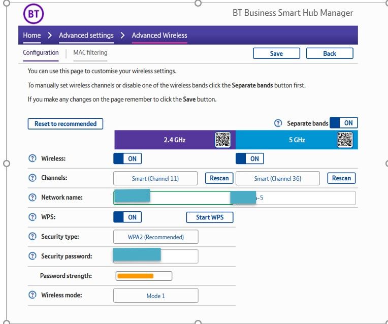

The weird thing is, on the Home Page, Wireless Tab, it says wireless is switched off.
However when I click to go into it, it says both bands wireless are switched on.
Posts: 14,857
Thanks: 7,748
Fixes: 480
@Crystal01
If you keep disconnecting from the Internet the FTTC DLM will kick in, thinking that you have a fault and slow your connection down.
Does your Advanced /Wireless page look like this?

Yes looks exactly like that
It's just on the Home Page, in the Wireless Tab, it says OFF
I've taken photos to show you what I mean..
(Wireless Off)

Try goimg in to the advanced wireless settings, turn the wireless for each band off, then save. Leave it a minute then switch it back on and save. Software can sometimes behave in very strange ways.

@Baldrick1
I tried that, but nothing changed.
I've put the Plusnet router back in place for now.
Might try BT again in a few days, see if anything changes.
